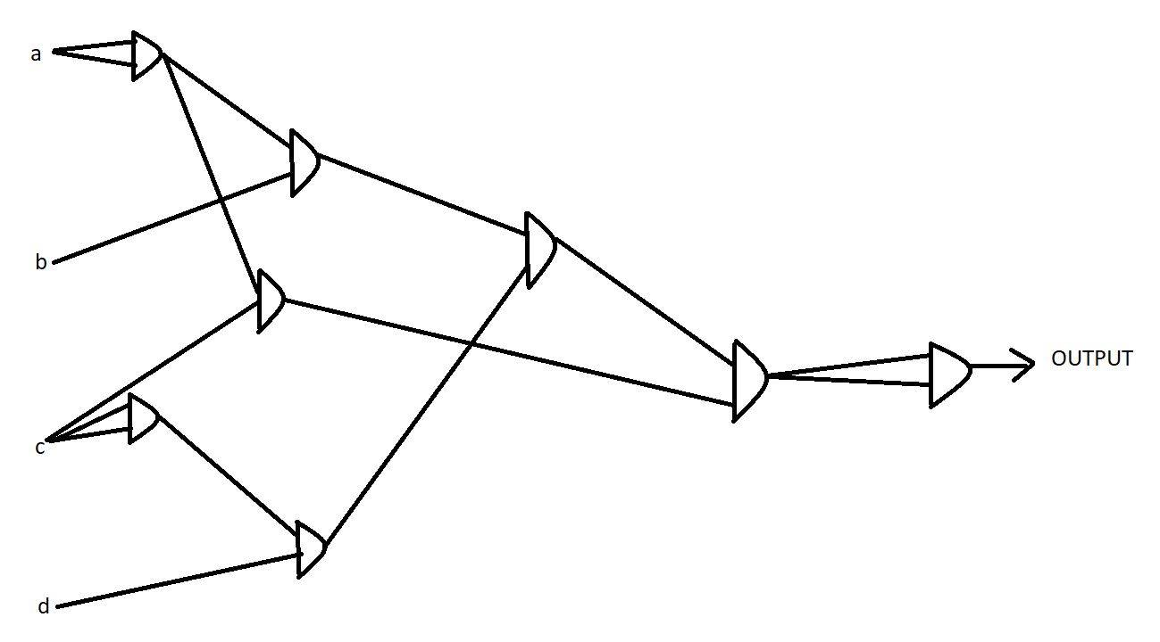

So we get:
Hand-drawn logic circuit with inputs a, b, c and d feeding a network of AND-shaped gates ending in a single output.
Is that correct? Is there an online program that we could draw the above? :unsure:

Let's start with $\lnot a\text{ NAND }\lnot b$.
You have a NAND to find $\lnot a$.
Shouldn't you also have a NAND to find $\lnot b$ before combining it with $\lnot a$? 🤔

It looks correct to me.
And I could check the circuit based on the expression on the right, so I believe that is good enough. 🤔
