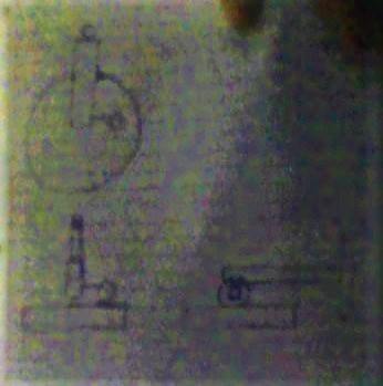

After starting this thread, I've thought of a way of drawing a true Archimedean spiral (I can't say I'm sure it will work, though).
Disc A is placed flat on the paper. Disc B is in contact with this one in this orientation. In this video, Disc A would be the wood disc and disc B would be one of the pink discs (ignore the differential):
Disc B is connected to a shaft and is allowed to slide across this shaft to change the gear ratio. This shaft is connected to a gear, and the gear is meshed with a rack. The edge of the rack would hold a pencil. Disc B, the shaft, the gear, and the rack, are allowed to rotate along the axis of rotation which goes through the center of Disc A. As it rotates, it causes Disc B to spin, causing the gear to spin, and causing the pencil to move outward or inward.
I'm not sure if I got the idea across clearly, but I think it's an interesting idea.

person123 said:
I'm imagining disc B rotating around the vertical axis at a fixed distance from the center while the shaft (which is connected to the pencil) moves inward or outward while rotating around the vertical axis. This keeps the gearing ratio the same while drawing your spiral.
It seems like you're imagining that disc B is the one moving inward or outward.
I was, with the pencil mounted adjacent to it. But it could work either way.
Wouldn't moving disc B toward or away from the center change the gear ratio, making the spacing of the spiral uneven? (You would also need to prevent the pencil from rotating around the axis of disc B). If that weren't the case, moving the disc instead might be easier than moving the entire shaft.
Ha! This approach cannot work. It will produce a geometric spiral.
As the shaft rotates dθ about the vertical axis the point of contact of the wheel with table moves rdθ (near enough). That will drive the wheel further away by αrdθ for some constant α. dr/dθ=αr.
The camera quality is terrible, but this a rough orthographic drawing from top, front, and side as I would imagine it to look like. It uses a rack and pinion, the pencil is shown, and disc B is replaced by a ball (which I think would be more effective).
