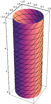

Hi WBN,
Here is my take on this. To have Born-rigid rotation implies that the angular velocity is constant, so there is no deformation. All that you have is that a line which is spatially straight in one frame will be spatially helical in another frame. Conversely, under some constraints if you draw a helical line there should be a frame where it is straight. There is no sense of twisting or strain involved, just different shaped lines.
Now, if you have a non-rotating cylinder and draw a straight line on that cylinder then it will be straight in all frames. If you then begin rotating it, there absolutely must be some deformation. It is impossible to maintain Born-rigidity. That deformation will lead to a helical line in some frames but the material is deformed in all frames.
I completely agree with you Dale. In my opinion the exercise would have been much better in demonstrating the dependence of spatial shapes of rigid objects on simultaneity slices of inertial observers if we just had a rigid rod in uniform circular motion about the ##x'## axis of the frame ##S'##.
The motion of the rod can be given parametrically by ##r(s',t') = \langle s', R\sin \omega t', R\cos \omega t'\rangle## in ##S'##, where ##s' \in [0,L]## with ##L## being the length of the rod in ##S'## which is of course constant in ##S'## since the motion is completely transverse to the length of the rod. The spatial shape of the rod in ##S'## is gotten by intersecting the worldtube of the rod with the simultaneity slice ##t' = \text{const.}## of ##S'## so in particular the spatial shape of the rod at ##t' = 0## is simply given by ##\langle s', 0, R \rangle## in ##S'## which is just a straight rod as we would expect.
Substituting in for the coordinates of frame ##S##, which is moving backwards with velocity ##-v## relative to ##S'##, we get ##r(s,t) = \langle \gamma (s - vt), R\sin (\gamma \omega t - \gamma \omega vs /c^2 ), R\cos (\gamma \omega t - \gamma \omega vs /c^2 )\rangle##. Intersecting the worldtube of the rod with the simultaneity slice ##t = 0## of the frame ##S## we get the spatial shape ##\langle \gamma s, -R\sin \gamma \omega vs /c^2 , R\cos \gamma \omega vs /c^2 )\rangle## which is a helix.
So in ##S'## the rod has the spatial shape of a straight line at an instant in ##S'## whereas in ##S## the rod has the spatial shape of a helix at an instant in ##S##.
I personally think this much better illustrates the effect of relativity of simultaneity on the "distortion" of spatial shapes because if you instead base the exercise on a cylinder rotating about the ##x'## axis (like the textbook referenced in this thread did), which we can think of as a collection of rods laid out around a circle in the ##y'##-##z'## plane, then while reach rod would look like a helix instantaneously in ##S## as shown above, the entire collection of helical rods would still form the exact same rotating cylinder as in ##S'## (except now its moving forward uniformly) so there's no way to even distinguish the two unless as you stated someone draws an explicit black line across the cylinder parallel to the ##x'## axis.
Would you agree? And thanks for the reply.
I personally think this much better illustrates the effect of relativity of simultaneity on the "distortion" of spatial shapes because if you instead base the exercise on a cylinder rotating about the ##x'## axis (like the textbook referenced in this thread did), which we can think of as a collection of rods laid out around a circle in the ##y'##-##z'## plane, then while each rod would look like a helix instantaneously in ##S## as shown above, the entire collection of helical rods would still form the exact same rotating cylinder as in ##S'## (except now its moving forward uniformly) so there's no way to even distinguish the two unless as you stated someone draws an explicit black line across the cylinder parallel to the ##x'## axis.
Would you agree?
By the way just to clarify what I meant in the quoted paragraph above, I've attached two diagrams with the striation curves on the cylinder made explicit, one for the ##S'## frame and one for the ##S## frame. Clearly if the striation curves on the cylinder were not made explicit, the effect of simultaneity on spatial shapes of rigid objects would seem non-existent in the case of the cylinder when compared to the obvious nature of the effect in the case of a single rod.
  • 3D plot of a vertical cylinder with a grid of curved striation lines wrapped around its surface, axes labeled from -1.0 to 1.0 horizontally and 0 to 6 vertically.
  • 3D plot of a vertical cylinder with dark curved helical striation lines wrapped around its surface, axes ranging from 0 to 6 on the vertical scale and -1 to 1 on the horizontal axes.
