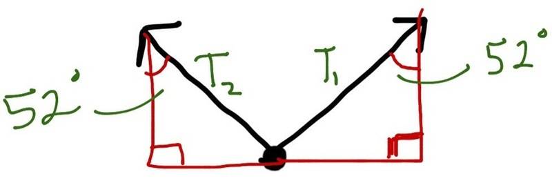

An object with a mass of 5 kg is suspended between 2 strings which sags at an angle of 52° Below horizontal on either sides. Draw a force diagram.
2. Attempt
santoki said:
An object with a mass of 5 kg is suspended between 2 strings which sags at an angle of 42° Below horizontal on either sides. Draw a force diagram.
2. Attempt
What is 90 - 42 ?
SammyS said:
What is 90 - 42 ?
I meant to put 52° so 90 - 42 would be 38°. I was wondering if my force diagram was correct.
