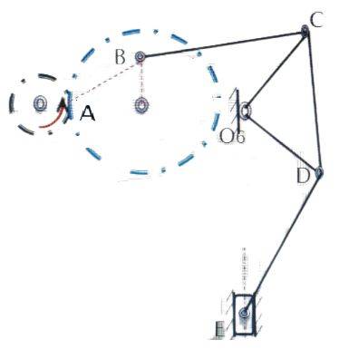

Draw a velocity polygon and identify absolute and relative velocity
Velocity polygon
Hello, I'm new to the forum, I want to ask help on this problem here, above is a press mechanism and I'm tasked to draw a velocity polygon based on this mechanism. The point of contact between the two gears is A and consider it as a swivel hinge (rotating but stay still), so I guess it's O2?
Here's my attempt
But I feel like it doesn't quite right, if you can help me solve this problem I would be very grateful thank you.

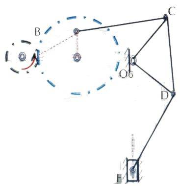

My mistake sorry, A is the point of contact between two gears. Now because the instructions that I've not put it in here says that considers A as a swivel hinge, then I assume then A becomes O2.
Here's the picture again, I edited the A and B so to not cause confusion anymore I hope.
Thank you.
If those discontinuous lines are the meshing circles of two gears with fixed centers, I don't understand the swivel idea.
The bigger gear should have a clockwise rotation.
In that case, the velocity vector of joint B should be represented as perpendicular to the radius of that gear and pointing to the right.
That vector then determines the velocity vectors of joints C, D and E.

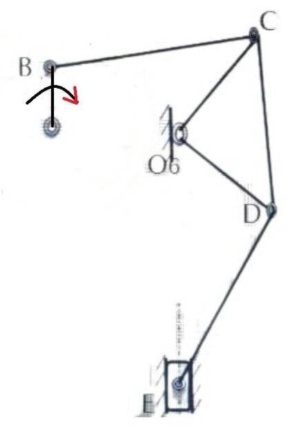

So can I see the problem like this?
Yes, but only if I am correct about the gears and other assumptions.
Could you consult with your professor?
Is it a number-less assignment, just to represent those vectors in a rough way?
Oh okay I understand, I will consult it when I have a chance,
Yes it's a number-less assignment
