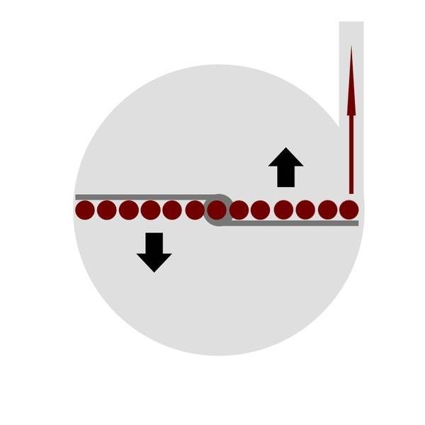

When you unbalance a rapidly spinning object, it's going to be a lot different than letting something fall from your hand.
Part of the problem constructing the device will be to deal with the resulting forces on an unbalanced rapidly rotating object. With strong enough materials and special construction it's theoretically possible, though I still don't know if there are any actual physical materials strong enough to allow the device as specified to be built. One way of constructing the device (at least in principle) is found by copying the desing of the household washing machine - the motor and rotor are connected together rigidly, but the whole assembly is suspended from cables, allowing them to move. Without some such special arrangement, the connection between the motor and rotor will break.
An analysis of the forces is still a complicated job. For starters,c onsider the following digram
left---------------right^
With "up" towards the top of the page, and "down" towards the bottom of the page, consider the sense of the rotation such that the right side is moving "up".
The clearest way to analyze the problem is to consider a non-rotating frame of reference, IMO - that has the added advantage of being the standard approach.
We can then ask the quesiton, with no other forces applied, what is the resulting motion when we detach a piece of the rotor on the right side?
The answer is that the detached piece will continue to move upwards. When we sum the total momentum of the rotating piece in the up down direction, we see that the rotating piece moves downwards. This momentum must remain conserved. The general motion of any rigid body will be a sum of rotation around it's center of mass, plus translation. So the motion of the main rotor will be that it will continue to rotate around its new center of mass (which will be displaced from the old center of mass), but it will also move downwards.
[add]
Note that the new center of mass was already moving downwards to start with, because it is located to the left of the original center of mass. It's original downwards velocity was w*dr, where dr is the amount the center of mass shifts to the left.
The shift of the location of the center of mass of the rotor is the key to solving the problem and getting the correct answer.
Anyway, that's the clearest way I can think of to describe the solution (it's a bit difficult with only limited diagrams and ascii text).
I've also simplified the problem somewhat - a real system would not only have a rotor, but a motor of non-negilgible mass to consider. I've omitted the motor in the simplified analysis.
It may help to draw a digram like the one above, with the velocities of all the parts shown as arrows. (I won't attempt to do this in ascii). You can then see visually how the rotational motion decomposes on the main rotor to the sum of a new rotational motion plus a translational motion downwards - you add up the arrows for the rotational motion around the new axis of rotation, plus the arrows representing the linear motion, and see that they add up to the original velocity vectors of the rotating bar.

Thank you for these details : I understand better the problem and I agree with you.
May be this device could work, but only at a very low speed, and of course the balls would not have enough power compare to a real weapon. I wonder if they have already build one, and I'd be interested to ear about their conclusions...

Another interesting point that came out of the last analysis is that the device will be throwing "curve balls". The original projectiles had angular momentum, which they will retain when they are released. Unfortunately the spin axis is oriented vertically, perpendicular to the direction of flight, which isn't a very desirable sort of spin. This is the same sort of spin that pitchers put on a baseball to make it curve, which is why I say that the device will throw curveballs...

epepep said:
This is from my retired physicist friend. He's fantastically intelligent -- nearly half as smart as he thinks he is -- which is a bunch. But he's still wrong sometimes, just like everybody else...
2. On first thinking, "no recoil" seems reasonable.
Actually, it isn't at all reasonable. I'm surprised that someone who is a retired physicist could make this mistake. I was actually surprised that there is so much confusion about this very simple issue even by non-physicisits. Especially after the correct answer was pointed out a number of times.
If you shoot bullets out of a gun, they carry momentum. This causes recoil, because momentum is conserved. That's really all there is too it!
Working out the details in terms of the motion of the body is slightly tricker, but not a lot so, and has already been done by myself in this thread a couple of times.
I think I've already suggested thinking about a rotating rod on a frictionless surface a couple of times already. Imagine the rod initially has a zero average velocity, i.e. it's not moving except the fact that it's spinning. If a small piece of this rod breaks off, the small piece goes forwards, and the large piece goes backwards!
There are a number of ways of seeing this, of which the fact that the center of mass of any closed system stays at the origin is only the simplest.
A more complex way of seeing this may be simpler for some people (?). If one actually draws out the velocity of each piece of the rod as a function of position, one finds that it's a linear function of position, i.e.
v = -5*w at x=-5, v=0 at x=0, v=5*w at x=5
which can be summarized by the simple equation
v = w*x
So what happens if the piece from x=4 to x=5 breaks off? It obviously moves forwards. What happens to the remeaning parts of the rod?
Well, each small piece of the rod maintains its velocity. We can decompose the velocity of the large rod segment which strteches from (x=-5 to x=+4) as the sum of a rotation around it's new center of mass (at x=-.5) and a linear velocity as follows:
v(x) = w*x = (x+.5)*w - .5*w
The first term, (x+.5)*w, represents the velocity due to the rotation around the new center of mass at x=-.5, note that this term is zero at x=-.5 as desired, because x+.5 represents the distance between 'x' and the center of mass which is at -.5. x - (-.5) = x+.5.
You can think of this as
v(x') = w*x' - .5*w, where x' is the distance of a point from the new center of mass, so that x' = x+.5.
The second term, -.5*w, represents a constant linear velocity that the rod segement as a whole has (a negative velocity).
This result, which could have been and was predicted from the conservation of momentum, should not be a surprise, especially after it's been explained so many times.
The small segment of the rod shoots forward, and the large segement recoils backwards. The center of mass of the enitre system stays at the origin. The total linear momentum of the small piece in the forwards direction is equal but opposite to the total linear momentum of the larger piece, because the total momentum of the system is zero.

there are probably millions of ways that we could try to counter act gyroscopic force and tensions but to look at this simply with the little information we have (hey they may invented some top secret material which is indestructible and all that) the costs for this one gun is going to be around the same as sending america to space so is the benefits that good to produce one? judging by the calculations u have made no the gun itself has no aiming capabilities whatsoever so really it is just fire and hope which isn't what u would want when having a barrel of a machine gun down your neck. the materials to be used are either so expensive or short supply so u would probably not get many of these weapons made and also the production costs are going to be huge and probably come out of tax payers pockets so i conclude that the money that will be spent on producing this is not worth the benefits (if any) that this weapon will provide.
  • #58
There will be no 'recoil' per say (a sudden force backwards when the weapon is fired), instead there will be a constant (or almost constant, probably oscillate slightly) force pushing back on you.
Because the bullets are 'slowly' accelerated then released you simple have the force spread out over a longer time.
It would definitely require some kind of mount. Because if you're firing continuously all of that inertia is being transferred to whatever's holding the weapon.
