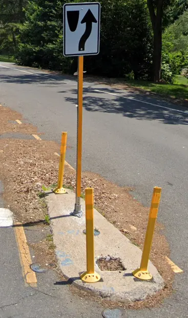

Great video - I agree 100% with her. The town where I live has been doing exactly what she discussed on many of its high-traffic roads. They've been installing traffic circles, curb bumpouts, lumps and bumps. I've been driving those roads for years both before and after the modifications and the change in driver behavior is very noticeable. There are still a lot of dumb, distracted drivers but at least they're not going 45 in a 25.
Here's an example of a very minor change that was done in the area that clearly changed driver behavior. I drive through this T-intersection every day on the way to and from work. The sign in the middle of the intersection here is telling people to keep right. That sign got mowed down nearly every week from drivers who were cutting the corner on their left turn. The town was very active in replacing it such that I would see it down on the way to work in the morning and when I returned in the afternoon, it would be back in place. Then, they decided to install the small yellow poles around it and the hit rate dropped from once per week to around 3 or 4 times per year.
Road sign showing a black arrow curving right around a central island, set on a small concrete island with three yellow flexible bollards around it at a road junction.
Street-level photo of a T-intersection on Vale Rd in Vienna, Virginia, with a sign on a concrete island ringed by short yellow posts, a traffic signal overhead and a parked dark sedan at right.
Yep.
"That sign just came out from nowhere officer!"
