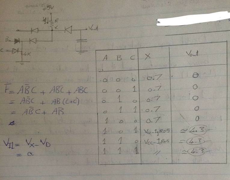

Hi Guys,
I'm solving a DRL related problem
https://dl.dropboxusercontent.com/u/49829206/skitch.jpg
I though the output diode were in forward . but I suddenly noticed that it's in reverse .. so I couldn't handle the answer. can anybody help,please?
oh Sorry ... here is it

Just as a general note, when you ask someone to do you a favor (like answering a question for you), it's not really a good idea to make it difficult for them (by, for example, posting a picture sideways so that it is very hard to read).

Ahmedzica said:
it isn't the same.. as they the anode of the output diode connected to voltage source
Ah, so it is. That causes me to conclude you have drawn it incorrectly, as I can see yours not functioning properly with that diode blocking the output. What do your classmates think?
◗ Where you wrote Vcc - I1R, can you describe the path I takes through your circuit?
◗ For inputs 1 0 0 I'd be inclined to estimate Vx as a little higher than 0.7V to distinguish that condition from some others (such as 0 1 1). Can you account for this?
◗ You gave one resistor a value, do you need to estimate a value for the other resistor, too?

This looks better: http://people.seas.harvard.edu/~jones/es154/lectures/lecture_7/DL_DTL/ls_dl.jpg

yes that's what I thought.. I solved it as the one right here
