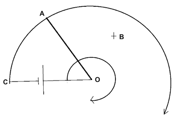

A conducting rod rotates in a plane perpendicular to the lines of induction ##B## of a 1 T magnetic field.
The axis of rotation passes through one end of the rod. The other end of the rod slides in an arc with a radius ##r## of 10 cm. Between
C and the point O of the rod's axis of rotation, a source is turned on
(see figure). Find the voltage drop between the
terminals of the source.
It is known that the resistance of the rod and the arc is
significantly less than the internal resistance of the source, the angular velocity ##\omega## of rotation of the rod is
300 Hz.
Note.
The figure shows the direction of magnetic
induction B and the rotation of the rod.
##\varepsilon=Blv##
##\omega=\frac{v}{r}##
IDK what else for now...
I do not really know how to solve this problem. For now I just have mathematical expression for ##\varepsilon## EMF. I think this is sources EMF. Correct me if I'm wrong.
##\varepsilon=Blv##. ##l## here is lenght of the rod so ##l=r##. ##v## here is linear speed of the rod.
##\omega=\frac{v}{r}\implies v=\omega r##
##\varepsilon=B\omega r^{2}##.
What should be going on further?
The equation that you quoted, ##\varepsilon=Blv##, is applicable to the case where all the points on the rod have the same velocity ##v##. Then you can say that the voltage drop from one end to the other is given by that formula.
Here, the linear velocity is ##v=0## at the axis of rotation, ##v=\frac{1}{2}\omega L## at the mid point and ##v=\omega L## at the end. You have to consider the voltage drop ##d\varepsilon## across a small length ##dr## and add all such voltage drops from one end of the rod to the other. In other words, you have to do an integral.

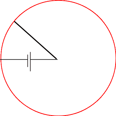

I think the description is not quite right. Guess there is a conducting circular ring (shown red below):

Hi, I don't have the basics of integral and differential calculus yet, but I dug a little deeper and could this be an expression for the voltage drop between the terminals? ##\varepsilon=\int_{0}^{L}B\omega r\ dr##
That is indeed the expression. If you don't know what to do with it, you have to wait until you learn how to integrate. You may wish to inform the person who assigned this problem to you that you lack the basics of calculus. It is important that you understand how this expression was put together in terms of what is going on physically.
