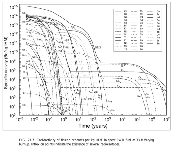

Each isotope has its own half-life and total amount. After one half-life, half of the isotope is decayed. After 2, half of the remaining amount is decayed (so 25% is left), and so on. After 10 times the half-life, 99.9% are decayed. The shorter the half-life, the quicker it will decay - but this leads to a higher initial intensity. There is no fixed time after which everything decayed, the activity just goes down forever.
If you plot activity as function of time, you get something like this.

Now, some practical examples: At Hiroshima and Nagasaki, rebuilding began quickly (~months) after the war. There was significant fallout, but most of the material was short-living, or spread in the environment quickly (the bombs exploded in the air). Today, radiation level (above the usual background) is negligible.
Chernobyl, on the other hand, still has significant radioactivity in the area around it, mainly from Cesium IIRC. This will slowly decrease in the next decades to centuries. A significant release of Cesium (+other stuff) in a reactor leak might be a good scenario.
