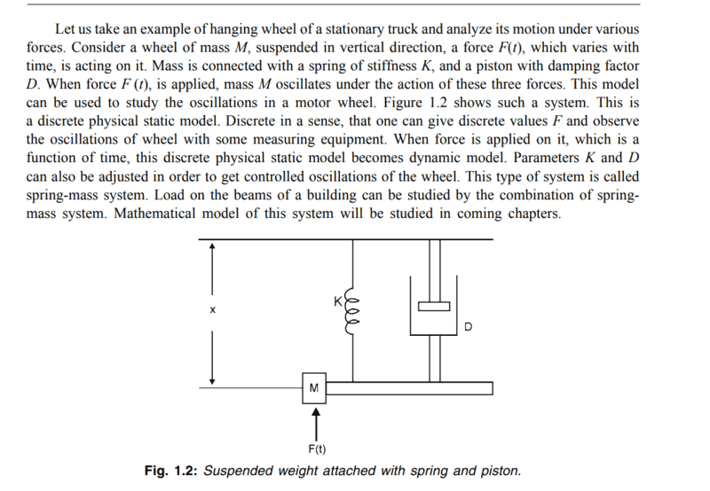

Been a long time I studied physics that had anything to do with mechanics, so I'm now in need of memorizing almost everything. So I am seeking for some guidance here. This is "system simulation/modeling/discrete event system simulation/etc" type of subject.
Diagram of a suspended wheel mass M hanging from a ceiling with a spring K and a piston damper D in parallel, with force F(t) acting upward on the mass and displacement x marked.

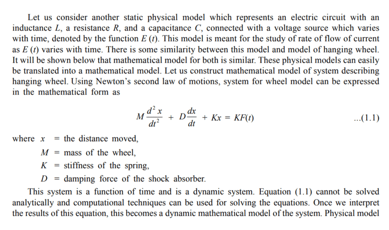

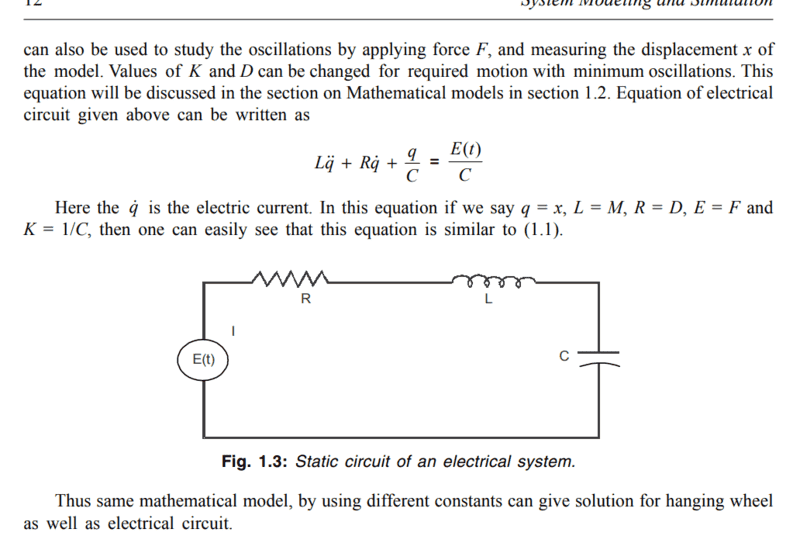

And I didn't understand how Newton's law of motion was applied to the first figure? And what law is applied in electric circuit in second figure? Coloumb's law? I forgot why are we using derivatives of current L and R but charge q for C?

##F = ma## is the law applied here. ##ma## appears as ##m{d^2x\over dt^2}## and there are three forces that add up to the ##F##. Maybe the fact that they moved over two of them to the other side of the ##=## sign is what confuses you a bit ?
The spring exerts ##F_s = -kx##
The dashpot exerts ##F_d = - D\dot x = -D {dx\over dt}##
And the exernal force is ##F_t##.
The ##K## in front of that in ##(1.1)## is in error. Likewise the ##{1\over C}## in the electric analogon.
(Check the dimensions).
Every other book about this is saying the same thing(written in that book) though.
How do you find dashpot force? I didn't get this.
Never seen the spring stiffness associated with the external force before and it doesn't make sense anyway. From Wikipedia:
Deriving the equations of motion for this model is usually done by examining the sum of forces on the mass:
a7595e04d4f8cb59560a2be5f12170a42afb66a4
https://en.wikipedia.org/wiki/Dashpot said:
A dashpot, also known as a damper, is a mechanical device that resists motion via viscous friction. The resulting force is proportional to the velocity, but acts in the opposite direction, slowing the motion and absorbing energy.
That's Kirchoff's Voltage Law which tells us the sum of potential differences around any closed loop is zero. Applying the law we get
$$E(t) - IR - L\frac{dI}{dt} - \frac{q}{C} = 0$$
You can then rephrase ##\frac{dI}{dt}## and ##I## in terms of the derivatives of charge ##q## . Does that clear your doubt?
Although like BvU said, the ##\frac{1}{C}## on the right has to be an error because the units don't add up. Hope this helped.
oh yeah KVL, thanks for the info. this helps for electric circuit doubt.
