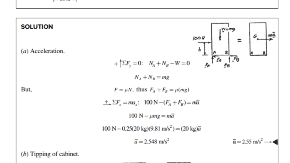

I have the solutions and questions below
Sum of moment = (Moment of inertia)*(angular velocity)
So for this question, when using point B as the centre of the moment, I get different sign for the mad term. If you take clockwise as positive than 100N force and the force at point G are causing a positive moment and gravity is causing an negative moment. But the solutions have different signs as my attempt I don’t understand why. Appreciate it if someone can explain this to me.

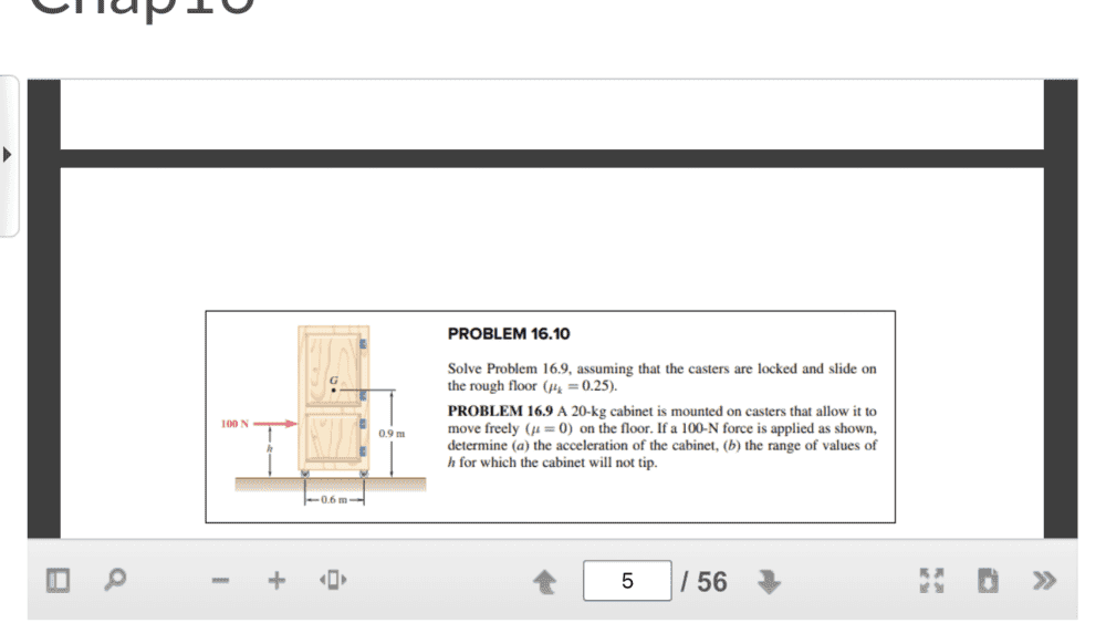

  • Screenshot of a textbook page showing a free-body diagram of a tall cabinet on casters on a floor, with a 100 N horizontal force applied at height h, center of mass G, and dimensions 0.9 m and 0.6 m, beside printed Problems 16.9 and 16.10.

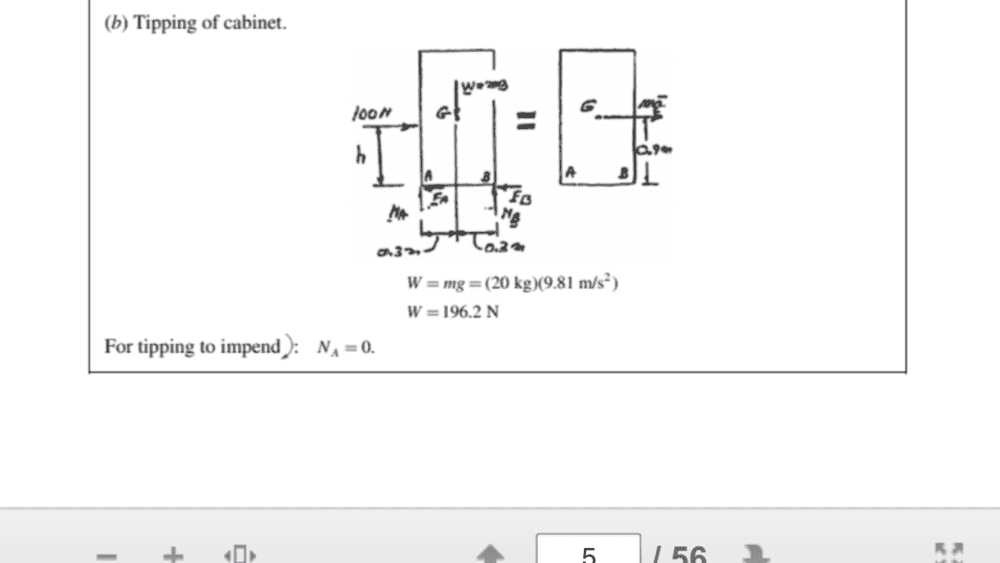

  • Handwritten free-body diagram of a tipping cabinet: a 100 N horizontal force at height h acts on a tall box with centre of mass G, supports A and B, and reaction forces NA, NB, FA and FB, with dimensions 0.3 m and 0.2 m; beside it, a second sketch shows the box after tipping with W = mg = (20 kg)(9.81 m/s²) = 196.2 N.

  • Solution page for a cabinet dynamics problem: part (a) finds acceleration from a free-body diagram showing W = mg, normal forces N_A and N_B, friction F_A and F_B, a 100 N push, height h, and mā at G, with the equations and result ā = 2.548 m/s² (2.55 m/s²).

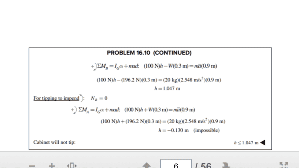

  • Worked solution from a dynamics textbook, Problem 16.10 continued, showing moment equations about points B and A for a tipping cabinet, ending with h = 1.047 m and h = -0.130 m (impossible) and the conclusion h ≤ 1.047 m.

About the pivot point B, you have the positive moment of 100 N times maximum h plus the negative moment of 0.3 m times weight.
Both moments should be in balance just before the cabinet starts to tip over.
What I’m confused about is the sign of the mad term. The solution has it such that the mad causes a negative moment when you move the mad term to the left side of the equation. Shouldn’t it the mad term cause a positive moment about point B?
I may be wrong, but I believe that there should not be a mad term in that equation.
The horizontal net force (100 N - friction force) is the cause, while acceleration a is the effect.
Remove the 100 N force, and acceleration inmediately becomes negative (for the case of μ=0.25) or zero (for the case μ=0).
There is horizontal acceleration, but there is no angular acceleration while height h has not reached its critical value to make the cabinet tip over.
As the point of application of the 100 N force gets higher, the value of the horizontal net force that induces the horizontal acceleration remains the same.
Nevertheless, the positive moment induced by the 100 N force gradually increases until reaching the value of the negative moment induced by the weight of the cabinet which until that moment had kept some force on legs A because it had been greater than the positive moment.
Please, see:
http://mechanicsmap.psu.edu/websites/6_friction/slipping_vs_tipping/pdf/TippingVsSlipping_WorkedExample2.pdf
At the impending tipping moment, there is no more force on legs A while each leg B supports half of the cabinet's weight, and both moments about B cancel each other.
