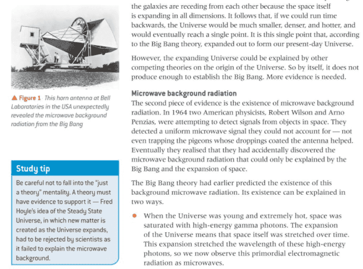

Hi,
Never done much cosmology but reading around I have found several sources saying the early universe (pre roughly 300,000 years) the early universe was full of gamma radiation. Since the universe has expanded this gamma radiation has been red shifted into the microwave region. Other sources do not mention the specific type of EM radiation in the early universe but state the temperatures (like this https://en.wikipedia.org/wiki/Chronology_of_the_universe). If you use the peak wavelength equation then these temperatures correspond to to infrared around 300,000 years when light no longer interreacted with matter. Please could someone clarify the main correct theory for the type of radiation there was around 300,000 years. Is the first description of gamma red shifting into microwave correct?
Thanks

I came to the exact conclusion PeroK did. I mean I haven't studied cosmology since high school but this is from my brother's A-Level textbook and the author has a doctorate in physics. The last paragraph says about gamma red shifting to microwave. I mean I know high school is simplified but surely this is just completely incorrect?
It is mistaken, yes. As the universe cooled, the typical photon energy reduced, but even in the visible spectrum, the photons would interact with hygrogen atoms trying to form. The gamma rays from the very early universe haven't survived.
Eventually, at about 380,000 years, the universe had expanded enough that photons had a good chance of evading interactions and relatively quickly the universe went from being opaque to visible light to being transparent to the now largely infrared radiation.
It is that infrared radiation that we can detect, although it has redshifted to microwave now. Radiation from before than time didn't survive as evidence of what the universe looked like. The light (in the shape of high energy photos) inevitably collided with and ionised hydrogen atoms, almost as quickly as they formed.

Well, now you know having a PhD doesn't make you immune to mistakes. The CMBR photons were, at the time of last scattering, more or less optical - certainly closer to optical than gamma rays.

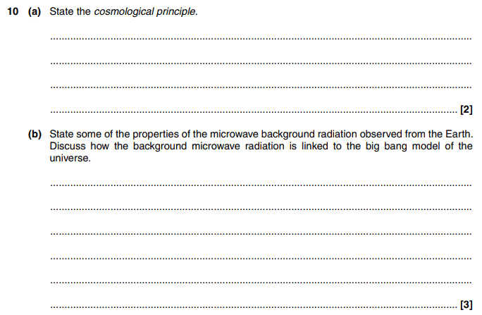

I am now even more concerned having searched through some past exam papers that questions ask for the origin of the CMBR and the answer in the mark scheme is gamma photons in the early universe.
That's very A-level-like.

No. It does not say anywhere that the radiation was gamma rays at the time the universe became transparent to radiation (i.e., at about 380,000 years).
PeroK said:
the temperature of the universe at 380,000 years was about 3000K
Yes, but the book being referred to does not say gamma rays were present at that time. It says they were present "when the Universe was young and extremely hot". It does not say when that was.
Jimmy87 said:
I don't understand any benefit of the approach they took. It introduces a theory that doesn't even exist.
This is not correct. The book, or at least the excerpt you give, is indeed leaving out a significant event (the universe becoming transparent to radiation, i.e., the "surface of last scattering" event), but what the book is saying is based on perfectly standard cosmology, a theory that certainly does exist. The book is describing what that theory is saying about a time much earlier than the time of last scattering: a time less than a second after the Big Bang, when the universe was filled with gamma rays. The theory then describes how the temperature of that radiation has changed from then to now.
In other words, the surface of last scattering did not produce radiation in a universe that didn't have any before; it just marks the point at which the universe became transparent to the radiation that was already present (because the hydrogen stopped being ionized and became neutral atoms). So the surface of last scattering does not explain the origin of the radiation.
I agree it would have been nice if the book had also mentioned the "last scattering" event at roughly the point where your excerpt comes from; but the fact that it didn't does not make what the book does say wrong.

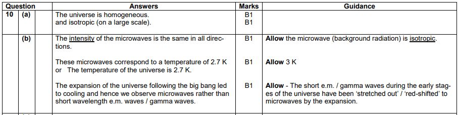

As I stated before PeterDonis' thread in post #16 it says this explicitly in the mark schemes for questions on the origin of the CMBR which supports the implication I outlined earlier (i.e. the CMBR is red shifted gamma radiation). Here is such a question:
And here is the exam board's official mark scheme for the question:
Reference: this exam questions was taken from: https://www.ocr.org.uk/qualifications/as-and-a-level/physics-a-h156-h556-from-2015/assessment/
Even in the guidance section it explicitly says 'allow gamma waves in the early universe are red shifted to microwaves'. This is why I don't see why they can't just re-write their course to say 'infrared radiation from 380,000 years has been redshifted to microwaves'. That seems no more complicated to me. Also I was flicking through the aforementioned textbook and they need to know all the key events after the big bang including the surface of last scattering at 380,000 years where they need to explicitly know that EM radiation no longer interacted with matter. So keeping this incorrect notion is in complete contradiction with the information they need to know about the surface of last scattering.

The early high energy radiation that existed in the very early universe did not make it to the surface of last scattering as I have understood it?
You have understood it wrong. The radiation was there from the very early universe on, and has been redshifted ever since then, but the universe did not become transparent to it until the surface of last scattering. (Note the name: surface of last scattering. "Scattering" is not the same as "emission".)
Jimmy87 said:
So if you take 'early gamma radiation is red shifted to microwave radiation' and this excerpt from the textbook:
A Level Physics for OCR A Student Book (OCR A Level Sciences)
by Graham Bone, Nigel Saunders, Gurinder Chadha
Yes, that does look inconsistent with what is said in the earlier excerpt you quoted. (And wrong; I would have said this time is when the universe became transparent to radiation.) Is this from earlier in the textbook than your previous excerpt, or later?
