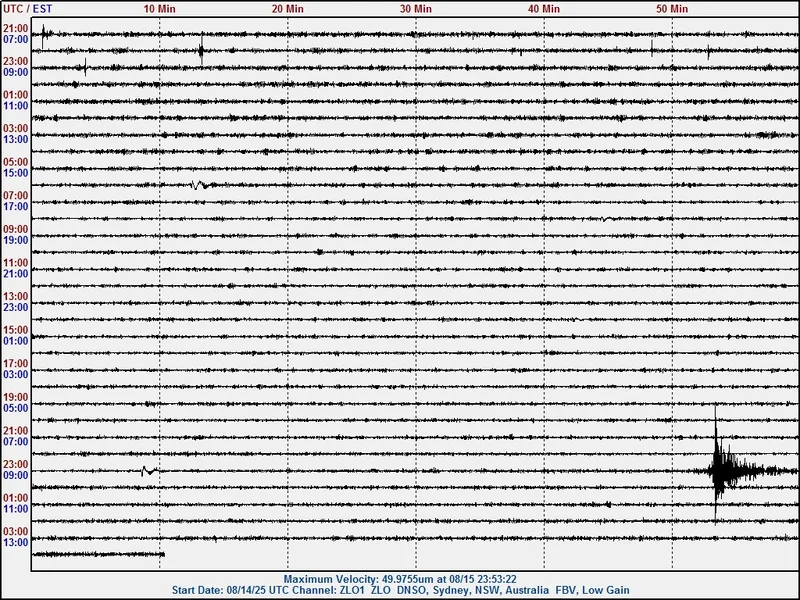

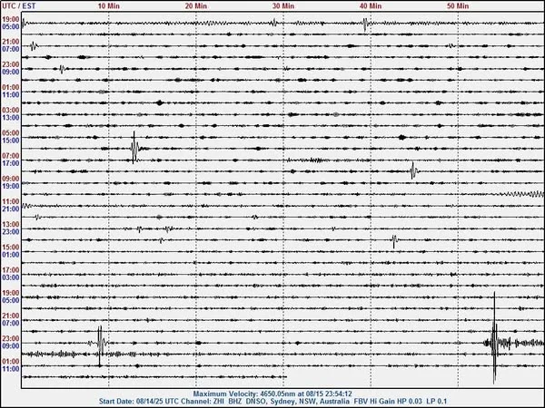

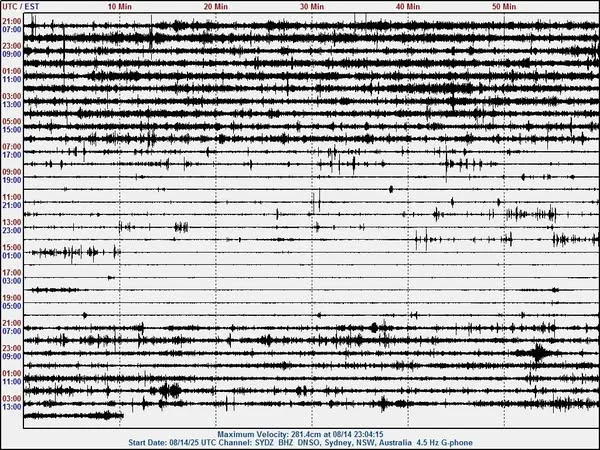

My recordings from Sydney ....
4.5 Hz Vertical geophone
1 second (1Hz) sensor
20 second long period sensor ---- similar response to the USGS sensor in Charters Towers, QLD
