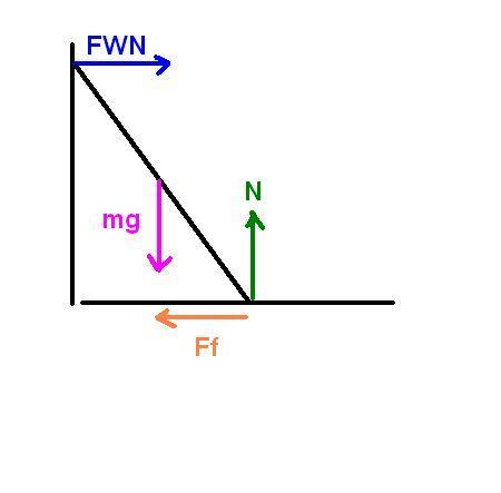

A uniform 15kg ladder whose length is 5.0 m stands on the floor and leans against a vertical wall,
making an angle of 25 with the vertical. Assuming that the friction between the ladder and the wall
is negligible, what is the minimum amount of friction between the ladder and the floor which will
keep the ladder from slipping.
(34 N)
torque = fperp * distance
I keep on writing stuff but never get the right answer (which is 1/2 tan theta * mg)
i have no idea how to get there. i keep mapping and drawing FBD and i can't get there... i think its my understanding of torque and not understanding where the pivot point on this ladder is...

Can you show your work in detail?

okay past this point I am not sure what to do..i assume the force wanting it to slip is Force-> (the horizontal ocmponent of MG) so i try to equate Ff (Friction) to The Force -> (Fparallelsintheta) but i get the answer 68 not 34...

i realize my problem lays in the fact i don't know what forces are acting on what and my free body diagram is probably wrong
The ladder is in rest, so the resultant force is zero and the torque is also zero.
You have vertical forces acting on the ladder: mg and FN (from the ground) and horizontal ones: FWN (the normal force from the wall) and the force of static friction, Ff.
How are the magnitudes of these forces related?
The forces have torque. Choose an appropriate point to write it up.

You do not need Fparallel. Write up the equilibrium for both the vertical and horizontal forces separately.

my problem is i don't know what forces are where
See figure. It is identical to your one.
mg acts at the midpoint of the ladder, vertically down. FWN acts at the upper end of the ladder, horizontal, away from wall. N and Ff act at the lower end of the ladder, N vertically up, Ff horizontally, towards the wall, as it is against slipping the ladder outward.

The ladder is a rigid body. To be in equilibrium (no motion) the sum of all forces has to be zero both the horizontal and vertical components. Also the torque has to be zero.
Do you see the forces? The ladder can not move vertically, so what forces have to cancel?
It can not move horizontally, so the horizontal forces have to cancel.
It can not rotate about its upper end so the sum of torques is zero.
Can you write up the corresponding equations?
