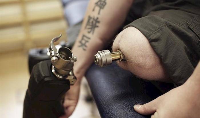

Well they do use skin penetrating sockets attached to the bone a lot today for amputees:
So I'm guessing that they manage to keep the risk of infection down to an acceptable level, or they would have just been sticking to the traditional cup sockets with no skin penetration with the disadvantages that has.
Actually, chronic infection is a huge problem for osseointegrative prosthetics. There's millions of dollars in research being poured into it.
