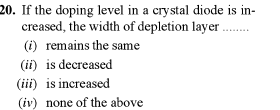

I think before getting the steady state, after doping there are more electrons in n-region and there are more holes in p-region, so the more electrons go towards the p-region and more holes go toward the n - region. Consequently the charges on the two sides of the depletion layer gets increased because of the doping.
After reaching the steady state, for an electron from n region going towards p-region, the negative charge at the starting of the p-region repels it and the positive charge at the n-region attracts the electron.
The resultant force on the electron due to these two source of charges in both type of p-n junction( doped and pure) should remain same.
Since, in case of doped p-n junction, the charges is comparatively more,the distance between the two sources of charges should get increased. Consequently, the width of the depletion layer should get increased.
The correct option is (iii). Right?

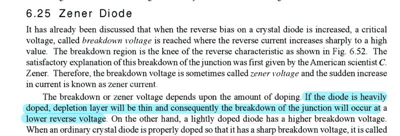

In eqn. (2) , it is noted that if we increase doping level, ##\Delta V_0 ## increases logarithmically.
While in eqn.(1), we see that if we increase doping level ##\frac{C_A +C_D}{C_A C_D} ## decreases faster than increase in ##\Delta V_0 ##. So, as a result, d decreases when the doping level is increased.
Thus, the correct option is (ii). Right?

Right!
Charges in the depletion region is due to the fixed ions, not mobile electrons. Right?
Correct. There are no mobile carriers in the depletion region. It is "depleted" of mobile carriers, which is why it is called the depletion region. The mobile carriers are swept out of the depletion region by the large electric field.
