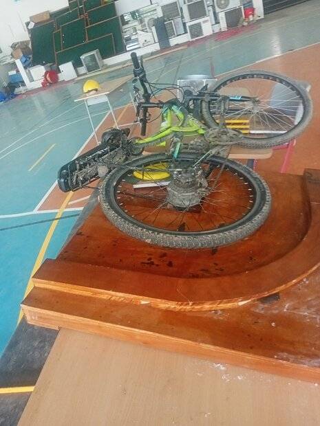

Anjish
How does varying thickness of rim width of frisbee affect the aerodynamics of the frisbee range and gyroscopic precession while keeping the angle of attack, mass of frisbees and the velocity constant? please help me with finding equations relevant and how I can experimentally deduce the variables if I have made one controlled frisbee launcher and have 5 frisbees with different width fo rim. THis is my research question for an investigation, so please tell something which can be experimentally deduced and worked upon.
range equation and finding some equations whcih can be tested experimentally
please help me in the quantitative aspect which way I can explore and what I should do?

Anjish said:
I am a high school student and that is why I need some guidance to do this project. I have made a frisbee launcher, mass and angle of attack are constant to isolate my IV rim width but facing difficulty with just the analysis and physics.
Hats off ! Quite a challenge you set for yourself ( I had guessed this would be for a PhD !)
I estimate the best you can do is make a set of graphs and see if you can hypothesize a relationship from them.

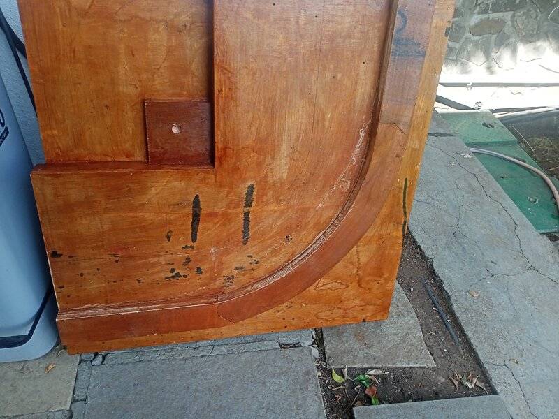

Cool. Can you upload some pictures? Use the "Attach files" at the lower left of the Edit window.
Basically, I use my electric cycle to provide the torque required to throw the frisbees in a controlled manner every time as it is though to control throws with humans. If you can help me with the mathematics and analysis that would be awesome.
