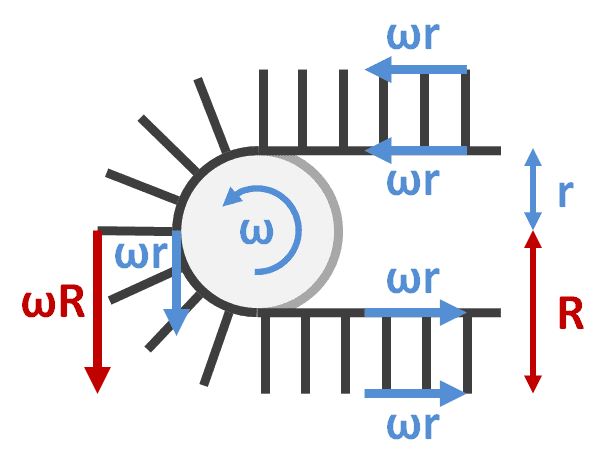

OldYat47 said:
Sheesh. No, there won't be a "jump discontinuity" at that point or at any other point on the track.
The speed of the track is not a single number. Since it has a non-negligible thickness, its speed varies from inner surface to outer surface as it passes over the drive wheel.
For a track of thickness R on a drive wheel of radius r, the tangential velocity of the outer surface is given by ##\omega (r+R)##. At the inner surface the tangential velocity is given by ##\omega r##. You have given no reason to equate the former with the speed of the track on the flat rather than the latter.
And yes, there is a jump discontinuity in speed at the transition from flat to curved for all depths within the track except, possibly, for one particular depth.
  • #49
Hey guys. Can you all settle on a simplification of considering the 'Track' to be a chain and the 'Lugs' retaining the same attachment as in the OP?
That might bypass getting tangled up in side issues.
  • #50
OldYat47 said:
Sheesh. No, there won't be a "jump discontinuity" at that point or at any other point on the track. I'm just trying to establish some common ground, which is beginning to look like an impossible task.
OK, looking at the frame of reference of the snowmobile, all points of the track make the same number of circuits around the track for a given number of rotations of the drive gear. How would you calculate the forward speed of the vehicle at any given RPM of the drive gear? Equations, please.
In the simplest model, there will, indeed, be a jump discontinuity. In reality, there will be a change in speed from the section going round the wheel and the straight section (this applies to all the wheels and all the straight sections around the track). If you do not believe that the track flexes then take a rubber belt and stick some non-stretch tape along inner and outer faces and then bend it around a cylinder. You will, of course, notice that the outside paper will split and in inner paper may actually bunch up. You have two different distances around the wheels, traveled by inner and outer faces of the track / belt. That means two different speeds.
What equations did you want? The only relevant equations are
1. Speed of inner surface of track is constant all the way round
2. speed of inner surface = speed of outer surface
along the flat, and:
3. speed of inner surface = R/(R+r) X speed of outer surface
around the curve (R is wheel radius and r is track thickness.)
If both those equations are true then the outer surface must change speed at the transition between curve and flat section but the

  • #51
Let me try to flesh out some equations for this.
Position one wheel of radius R with its center at the origin, (0,0). Position a second wheel of radius R at a distance d to the right so that its center is at (d,0). Paint a dot on the inner surface of the track. At time t=0 this dot will be on the top of the first wheel at coordinate (0,R). Refer to the position of the inner dot as ##(x_i(t), y_i(t))##. Paint a dot on the outer surface. At time t=0 this dot will be on a distance R above the top of the first wheel at coordinate (0,R+r). Refer to the position of the outer dot as ##(x_o(t), y_o(t))##
As per the simple model, the dots move in lock step so that a line perpendicular to the track through the inner dot runs through the outer dot as well. As per the simple model, the distance between the dots is always equal to R.
Assume that the track has a velocity v in the clockwise direction. The dots begin by moving to the right on a stright line path from the top of the first wheel to the top of the second wheel. The position functions for the two dots are given by:
##(x_i(t), y_i(t)) = (vt, r)## for 0 ≤ t ≤ d/v
##(x_o(t), y_o(t)) = (vt, r+R)## for 0 ≤ t ≤ d/v
It is clear that differentiating either position function with respect to time will yield a constant speed equal to v for 0 ≤ t ≤ d/v.
At time t=d/v, the dots will have reached a point directly above the axle for the second wheel and will transition from the flat portion of their trajectory to a curved portion. Match the angular rotation rate to preserve the speed of the outer dot by setting ##\omega = \frac{v}{R+r}##
NOTE: This is an arbitrary choice. Nothing in the simple model requires this choice. One could equally well choose to set ##\omega = \frac{v}{R}## or use any other arbitrary depth within the track by setting the divisor equal to something in the range [R, R+r]. One could even go a little crazy and imagine scenarios where depths outside that range would be appropriate, but let's keep things simple.
Substituting for omega and putting in an appropriate shift to match positions at t=d/v, the position functions for the two dots are then given by:
##(x_i(t), y_i(t)) = (d+R\sin(\frac{v(t-\frac{d}{v})}{R+r}), R\cos(\frac{v(t-\frac{d}{v})}{R+r}))##
##(x_o(t), y_o(t)) = (d+(R+r)\sin(\frac{v(t-\frac{d}{v})}{R+r}), (R+r)\cos(\frac{v(t-\frac{d}{v})}{R+r}))##
Both valid for ##\frac{d}{v} \leqslant t \leqslant \frac{d}{v} + \pi\frac{R+r}{v}##
[I think I have those equations right]
Feel free to differentiate the above with respect to time and take the magnitude of the result to obtain speeds ##v_i(t)## and ##v_o(t)##. Everything simplifies dramatically. As expected from the physical situation, the result should be a pair of constant functions:
##v_i(t)=v\frac{R}{R+r}##
##v_o(t)=v##
NOTE: the speed of the inner dot ##v_i(t)## has a jump discontinuity at the time of the transition from flat to curved from a speed equal to ##v## before the transition to a speed of ##v\frac{R}{R+r}## afterward.
Edit: Note that the relevant observation has been made previously in this thread, notably at post #32 by A.T.

  • #54
A.T. said:
Actually, the OP should clear up what is meant by "changing the lug height" with a diagram, that shows:
- Where the drive sprocket teeth attack
- Where the track links are connected
- What part is being changed / extended
We here and the people in the original thread might have different ideas on this, and thus might be talking past each other.
Here is my simplified understanding of the scenario:
The speed of the vehicle on hard surface would be ωr and is not affected by the lug length.
  • #55
The tip speed... is not affected by the lug blade length.*
Would you say the same thing about an airplane propeller, or a helicopter rotor blade?* Note: My modifications to quote...
