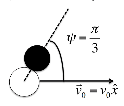

A super cue ball is made of the same material with the target ball (radius r) but slightly larger: rc = (3)^(1/3)*r The cue ball collides with the target ball on a frictionless table, as shown below, with initial speed of v0. The collision is not head-on, as shown below.
a) What are the velocities of the two balls after the collision? You need to determine both the speeds and directions!
b) In the CM frame, what is the target ball’s direction, relative to the x-axis?

if i use conservation of linear momentum and kinetic energy conservation, i end up with two sets of equations but one is a vector equation and the other is not, so i don't know how to even start this problem
  • Diagram of a non-head-on collision: a large white cue ball moving right with velocity v0 = v0 x-hat, and a smaller black target ball touching it at the upper left, with a dashed line of centers at angle psi = pi/3 from the x-axis.

There should be a figure to the problem. Attach it please!
The vector equation can be written as two scalar equations for the components of the linear momentum. So you have three equations.

Oh right! its there now.
OK. So the velocity of the target ball encloses the angle pi/3 with the original velocity of the cue ball after the collision. The direction of velocity of the cue ball is unknown after collision. And energy is conserved. Write the equations for the components of the momenta, and also for the conservation of energy.

Ok so this is what I've done so far
m1<u1x,u1y> = m1<v1x, v1y> + m2<v2x, v2y>
where u1 is the velocity of mass 1 before the collision, v1 is the velocity of mass 1 afterwards, and similarly for mass 2.
I end up with
(√3)/6 v2 + v1cos(φ) = v0 where v0 = u1x these are the magnitudes of the velocities
v2 = -(6/√3)v1sin(φ)
and then the energy conservation expression
3v02 = 3v12 + v22
does this look ok so far?

Check the equations, there are mistakes in both.

The energy equation is OK.

m1<u1x, 0> = m1<v1x, v1y> + m2<v2x, v2y>
<m1u1x, 0> = <m1v1x, m1v1y> + <m2v2x, m2v2y>
<m1u1x, 0> = < m1v1x + m2v2x, m1v1y + m2v2y>
therefore,
m1v1x + m2v2x = m1v0
m1v1y = -m2v2y
3v1cos(φ) + ½v2 = 3v0
v2 = -(6/√3)v1sin(φ) still got the same thing for this one

It is OK. But do not forget, that you get negative angle φ. The cue ball moves under the x-axis after collision.
Isolate cos(φ) and sin(φ), square and add the equations, so as φ eliminates.
