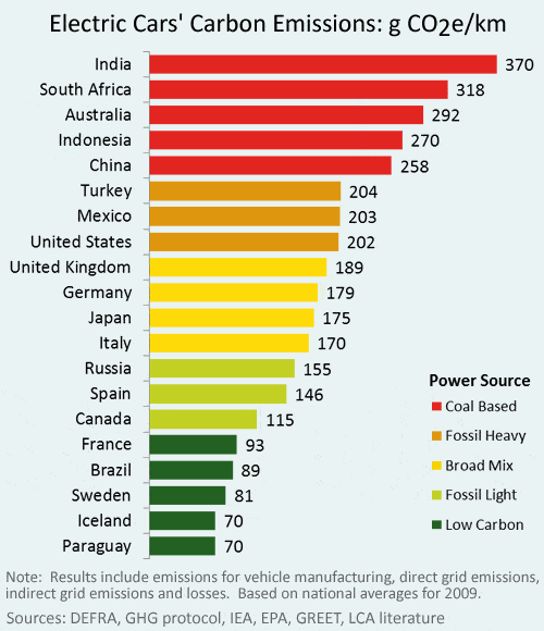

List of EV emissions (grams carbon) when charged by the grid average in various countries. Compare that to the emissions from the average combustion vehicle which the EPA keeps somewhere ...
Edit: EPA uses some 8.8 kg emitted per gal gasoline, so for a 25 mpg car that's 220 grams per km, the units used below. There are some other details, such as the 15% energy overhead for refining petrol, etc.
