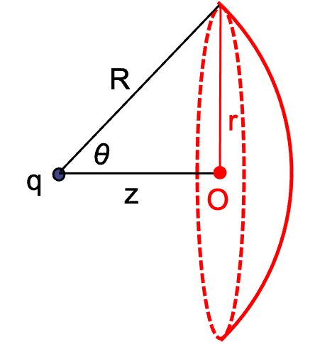

You can always calculate the flux through a circular disk of radius ##r## when charge ##q## on the axis of the disk at distance ##z##. See diagram on the right. The disk (dotted line) can be considered to lie on the surface of a sphere of radius ##R## centered on charge ##q##. You know that
  • the electric field on the surface of the sphere is ##E=\dfrac{q}{4\pi\epsilon_0R^2}.##
  • all electric field lines that cross the surface of the disk must cross the surface of the spherical segment delimited by the dashed circle.
  • $$\Phi_E=\int_S\mathbf E\cdot \mathbf{\hat n}~dA.$$
Can you do the last integral to find the flux?
