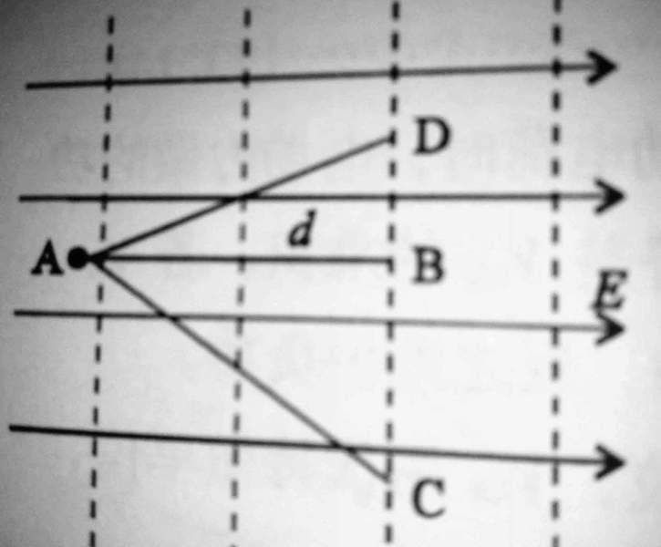

I went to check the derivation of the formula E=V/d.Referring to the graph,the work done to move charge A to B can be expressed by:
W=qEd or W=qVAB
Therefore by eliminating q,VAB=Ed,so E=VAB/d

E=kq/r² does not apply directly to parallel plates. It is for point or spherical charges.
Q is the charge on each plate.
