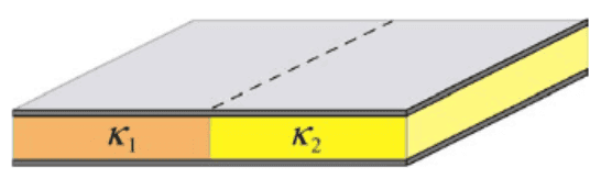

Two dielectrics with dielectric constants ##\kappa_1## and ##\kappa_2## each fill half the space between the plates of a parallel-plate capacitor as shown in the figure below.
Each plate has an area ##A## and the plates are separated by a distance ##d##.
Compute the capacitance of the system.

We have a parallel plate capacitor with two different dielectrics
It seems to be the case that the potential difference on each half of the capacitor is the same.

If the potential difference is the same in the two halves, then it must be that the electric fields are the same in the two halves. But then the charges on the halves must differ.
Does the reason the potential difference is the same on the two halves arise because of the path independence of ##\vec{E}##?

The potential difference is the same for the two halves because of the electrostatic properties of conductors. For any conductor in electrostatic equilibrium, what can you say about the potential at two different points of the conductor?
Suppose you have two conductors that are each in electrostatic equilibrium. What can you say about the potential difference between any point of one conductor and any point of the other conductor? Does it depend on the choice of points?

The potential inside each conductor is constant. Thus, the potential difference between any point inside one conducting plate and any point inside the other conducting plate is constant.
Suppose that instead of conductors we had charged sheets as capacitor plates.
Now what is it that prevents the potential difference from being different in each half of the capacitor?
If the potential difference is the same......as we've established. Are the two different capacitors in series or parallel?

If the charge density is fixed on each sheet so that the charge cannot move around on either sheet, then the electric field inside the two dielectrics would be different. So, the potential difference between the sheets would be different for the two halves. We would not call this system a capacitor, since the sheets are not conductors.
