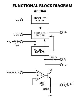

I didn't really understand this converstion to dc diagram:
Study text surrounding fig6 page 8 ?
But i think they have a typo, confusing I4 and I2 I2 might have been Ipin4 in an earlier draft ?
