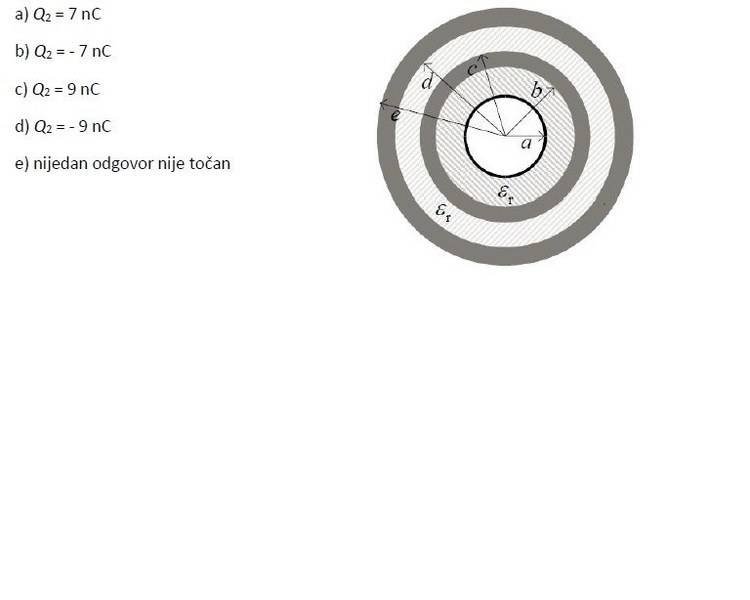

Metal ball ( Figure 5) radius a = 5 cm , is surrounded by two concentric metal shell of radius b = 10 cm and c = 15 cm , and d = 20 cm and e = 25 cm . The relative permeability of the dielectric between the ball and the first shell , and between the two shells is εr is 4. Outside the outer cross air . The charge of possession Q1 = 1 nC , a charge the outer shell is Q3 = -1 nC . What is the charge on the inner shell ( Q2 ) when the potential of the sphere and the outer shell ( in relation to the reference point at infinity ) are equal ( V1 = V3 )
{image inserted by moderator}
Tried to do this twice but I am getting the wrong result,it is supposed to be -7nC and I am getting 5nC, I can't see what am I doing wrong.

I integrated from inifinity to e to find the potential V3 and from infinity-->e---->d----->c---->b---->a to get potential V1 and made V1=V3 ,I don't see any other way of doing this, only if something is wrong with my equations?

It looks like you found out the amount of work to assemble a sphere of known charge at the outer radius, then found the work to assemble a sphere charge Q at the ball radius, then found out the value of Q that makes these two figures the same. Something like that? Walk me through the physics you are using.
Note: I don't see a Q1 or a Q3 on your diagram.

Okay guys it's solved,sorry for the bad handwriting I don't know how to post it other way because I don't know how to use latex, and I've made mistake with '-' sign in my equations that was the reason for wrong result.I got Q2=-7nC now.

I used formula for electrical potential ,-integral of E*dl integrating from reference point to point r(for V3 r=e)
Integrating from infinity to e gives ,where by gauss law in the vacuum using only epsilon zero in k ,E = k*(Q1+Q2+Q3)/r^2 , I get V3=k*(Q1+Q2+Q3)/e,
now integrating(V) from point e to point d ( there is no E field in the metal so Ved = 0), integrating from d to c where there is some insulator with epsilon=4*epsilon0 I get by gauss law E= (Q1+Q2) /4pi*epsilon*r^2 ,and V2= V1 + ((Q1+Q2) /4pi*epsilon ) * (d-c/c*d).
Gauss law going from c--->d ,no charge ,no E field.
at b>r>a , Q=Q1 , so by gauss law I get that E = Q1/4*pi*epsilon * r^2 , and using integral for V from b to a ,I get V1 = ( V2 + Q1/4*pi*epsilon )*(b-a/a*b)
since V3=V1
V3 = V3 + ( Q1+Q2/4*pi*epsilon)*(d-c/c*d)+(Q1/4*pi*epsilon)*(b-a/a*b)
Put all the unknowns in and you get
Q2= - 7nAs
This solution was posted in my pictures.I just messed up with signs somewhere , maybe I didn't made myself clear enough , that was the reason I wasn't posting the same solution , but I had to now.

These expressions for V1 and V3 are not correct. The dielectric constant K should appear in the denominator, not the numerator. You also need to include Coulomb’s constant k that would appear in the numerator (or, equivalently ##4 \pi \epsilon_0## in the denominator).
To get a correct expression for V3, start at infinity where V = 0 and think about the change in potential as you move from infinity to the surface of the outer conductor (r = e). In the region of space where r > e, there is no dielectric material. So, the dielectric constant K is equal to 1 in this region.
But you actually don’t need to worry about getting an expression for the potential V3. We just want to make sure that V1 = V3. In other words, we require the change in potential ΔV d→ a to equal zero as we go from a point on the outer shell to a point on the sphere. Note that
ΔV d→ a = ΔV d→ c + ΔV c→ b + ΔV b→ a.
Each of these terms can be worked out without having to know the potential V3 or V1
This is what Ivan did in post #12.

You should get the correct expression for V3 with these corrections. However, I think your expression for V1 will need more work. The only way that I can see to get V1 is to start with V3 and then add the additional change in V as you go from the outer shell to the sphere.
But if you can get an expression for ΔV as you go from d to a, then you can solve the problem by just setting ΔVd→ a = 0. You won't need to know V3 or V1.

This is not correct. For example, I believe the potential at the sphere due to just Q2 works out to be ##V = \frac{Q_2}{4 \pi \epsilon_0} \left( \frac{1}{e} + \frac{1}{Kc} - \frac{1}{Kd} \right)##, where K is the dielectric constant (K = 4). To find this, you need to consider the electric field produced by Q2 alone and then consider the potential produced by this field.
Likewise, you can work out the potential at the sphere due to just Q1 or just Q3.
But, I think it's much easier to solve the problem by determining the net electric field with all the charge in place and then consider the potential difference between the outer shell and the sphere using this net field. This is Ivan's method.
