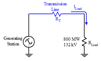

Consider the phrasing of the original problem statement:
A particular transmission line delivers 800 MW of power at
132 kV to the user. It loses 1% of the transmitted power as heat.
800 MW at 132 kV is delivered to the user. That's what ends up across the eventual load. If 1% of the generated power is being lost in transmission, the generating station must actually be generating 808 MW at its end of the line.
You know what the user is receiving. From that information you can determine the current in the load and hence the transmission line since they are in series.
243259
The transmission line is dissipating ΔP = 8 MW of power. So ##\Delta P = I^2 R_T## and solve for ##R_T##.
ahhh gotcha makes perfect sense now , cheers m8
