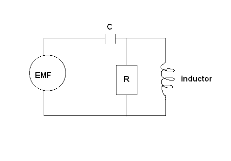

Hi all.
Please take a look at the attached circuit. I've have found the amplitude of the current through the resistance to be:
[tex] \left| {I_0 } \right| = \frac{{\varepsilon _0 }}{{\left| {R - \frac{R}{{\omega ^2 LC}} + \frac{i}{{\omega C}}} \right|}},[/tex]
where ε_0 is the amplitude of the EMF, and the EMF is given by ε_0 cos(ωt). This is all good (and correct too! :approve:), but in my book it says that in general, the amplitude of the current is given by:
[tex] \left| {I_0 } \right| = \frac{{\varepsilon _0 }}{{\left| Z \right|}},[/tex]
where Z is the impedance. So according to my book, the amplitude of the current through the resistance must be:
[tex] \left| {I_0 } \right| = \frac{{\varepsilon _0 }}{{\left| {R - i\omega L + \frac{i}{{\omega C}}} \right|}}.[/tex]
What's wrong here? I mean, I know my result is correct, but it is obviously not the same as the one my book wants. What impedance is it I have in my denominator then?
Thanks in advance.Niles.
  • Circuit schematic with an EMF source on the left, a capacitor C in the top branch, a resistor R in a middle branch, and an inductor on the right side.
Something's amiss here. Don't know where your first equation came from, but the third equation (from your book, you say) describes a series tank circuit and not the series/parallel circuit you drew.
Note that
[tex]{R - i\omega L + \frac{i}{{\omega C}}}[/tex]
would be the impedance if all three elements were in series. However that is not the case in the circuit you show.
