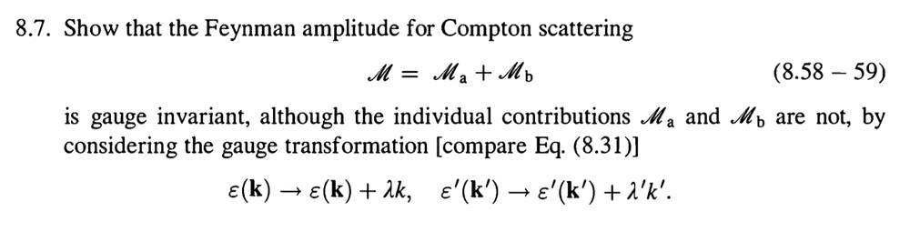

Show that the Feynman amplitude for Compton scattering ##\mathcal{M} = \mathcal{M}_a + \mathcal{M}_b## is gauge invariant while the individual contributions ##\mathcal{M}_a## and ##\mathcal{M}_b## are not, by considering the gauge transformations
$$\varepsilon^{\mu} (\vec k_i) \rightarrow \varepsilon^{\mu} (\vec k_i) + \lambda k^{\mu}, \ \ \ \ \varepsilon^{\mu} (\vec k_f) \rightarrow \varepsilon^{\mu} (\vec k_f) + \lambda' k^{'\mu}$$
This is exercise 8.7 in Mandl & Shaw
Please see below

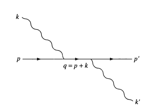

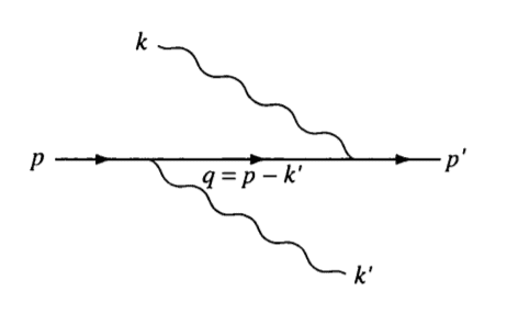

Alright. Let me change notation for the internal momenta: it will be labeled as ##q##. Energy-momentum conservation at each vertex implies ##q=p_i +k_i = p_f + k_f##, so we have
$$\mathcal{M}_a = -e^2 \bar u(\vec p_f) \varepsilon\!\!\!/ (\vec k_f) iS_F \left(q=p_i +k_i = p_f + k_f \right) \varepsilon\!\!\!/ (\vec k_i) u(\vec p_i)$$

Yes, but notice that the momentum ##p## or ##q## is different for both amplitudes.

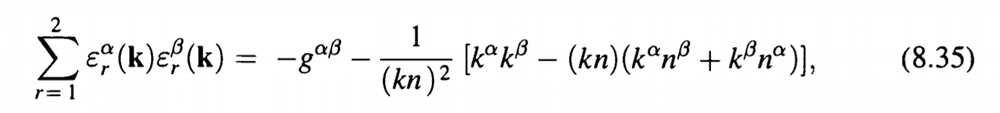

I've been reading a bit and found the following relation (Mandl & Shaw, page 135)
Equation (8.35): sum over r from 1 to 2 of epsilon_r^alpha(k) epsilon_r^beta(k) equals minus g^{alpha beta} minus 1/(kn)^2 times [k^alpha k^beta minus (kn)(k^alpha n^beta + k^beta n^alpha)].
Is this the approach you were picturing in your mind?

No, I don't think this is necessary. You are not summing over polarizations, the amplitude must be invariant for each polarization.

Textbook problem 8.7: show the Feynman amplitude M = Ma + Mb (equations 8.58-59) is gauge invariant, though Ma and Mb individually are not, using gauge transformations ε(k) → ε(k) + λk and ε'(k') → ε'(k') + λ'k'.
Besides, I have been reading M&S pages 134, 135
