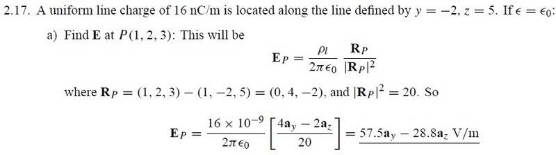

I've found this problem (in the attachment) with its solution:
RP = (1, 2, 3) − (1,−2, 5) = (0, 4,−2)
Why did it assume that line defined by y=-2 and z=5 have the point (1,-2,5)? why not (0,-2,5)?

Re your problem 1b: the distances to the two lines aren't the same any more. You have to add two E vectors with different magnitudes and different direcetions.
RE problem 2.17: You want the distance to the line, not just to any point on the line.

How did you know that the x component is 1? I'm told in the problem the line is defined by y=-2 and z=5, why didn't defined it by (0,-2,5) or (x,-2,5)?
1b: looks good. Final answer is adding the two.
The new problem you brought in: any point on the line has (z, 0, 0). Distance from 1,2,3 to such a point is √ (1-0)2+(2-0)2 +(3-z)2. The distance to the line is the minimum of that, which is reached for z =3.
2.17: on the line, x can be anything. Distance from 1,2,3 to a point (x,-2,5) on the line is √ (1-x)2+(2-(-2))2 +(3-5)2. Distance to the line is minimum of that, which is for x = 1.

For the new problem and problem 2.17: What I've understood that I can get my desired point on a line depending on the point of interest, which was (1,2,3) in the new problem and hence I've ended up with 3 in the z coordinate of the line.
Thank you very much, I really appreciate your help.
You can also look at it this way: your y=-2, z=5 line runs parallel to the x-axis so a line connecting a point (a,b,c) to the y=-2, z=5 line must have the same x=a value on the y=-2, z=5 line in order to be perpendicular to the y=-2, z=5 line.
Think 2-dimensions: let the line be y=3 and the point be (4,5). The if you draw a line from this point to the line y=3 it's obvious that the perpendicular line must intersect the y=3 line at x=4, right?
So then d^2 = (4 - 4)^2 + (5 - 3)^2 etc. See the same 4's? That's why you have the same 1's in your 3-dimensional problem.
