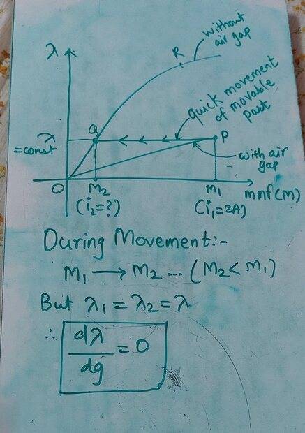

Here, I have assumed very quick movement of the moving part. So, as per the mmf-flux curve, flux linking with the system will be unchanged during the movement. To support this assumption, I have made use of the following analysis.
In this graph, the movement of the part happens quickly (small air gap), hence, the the flux linkage will remain unchanged (line PQ) throughout this small interval.

It looks like some information is missing in this problem, IMO. A 10cm air gap is giant, unless the cross-sectional area of the magnetic core is also huge. What are the rest of the dimensions for this system? What are the dimensions of the metal piece in the air gap? Is it magnetized?
If it's not magnetized, then it will be the non-uniformity of the flux in the air gap that will attract the moving metal piece to one of the core surfaces at the air gap (whichever is closer when the metal piece is released), no?
