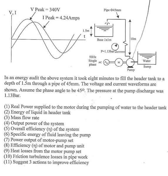

1. I am having trouble selecting the proper equations for each stage
2.Im not looking for anyone to do it for me , but i would appreciate if some one could tell me what EQUATIONS TO USE at each part of the question
3. i have gotas far as question five

Can you show the equations and your solutions for the parts that you have done so far?

Q1: I USED EQUATION P/real=V*I*Cos ∅
P/real=340*4.24*Cos 45
P/real=1019.37 (W)
Q2:I USED EQUATION PE=MGH (mass of water =1000)
PE= 1500*9.81*10 (gravitity =9.81)
PE= 147150 (Joules)
Q3:I USED EQUATION Mass Flow= Mass/time
= 1500/480 ( 8mins =480 seconds)
= 3.125Kg/s
??Q4:1 USED EQUATION P=I*V
=4.24*340 OR should i of used Pout=Work done /time
= 1441.6 =147150/480
=306.56(watts)
??Q5 I WILL USE EQUATION Power out/Power in *100 to establish my efficency
Im not 100% that I've used the correct EQUATIONS , as each question draws on your previous answer , Any help would be appreciated. Thanks.
For Q1 I think you'll want to use RMS values of voltage and current if you're looking for power. The supplied diagram gives them as Peak values.
Q2 is a bit vague, asking for "The energy of liquid". presumably they mean the gain in gravitational potential energy as you've done it.
For Q4, I guess they're looking for the rate of mechanical work being done, since lifting the water is the 'output' of the system.
For the rest of the questions, I'm afraid that I'm not very familiar with the jargon or conventions involved in fluid/electromechanical system audits...:redface: So, for example, I'm not sure what would be included in the 'specific energy' of the water leaving the pump; Does it include per unit volume kinetic energy and pressure? Gravitational potential energy too?
Yeah, it is rather vague, but I'll motor on with what I've got... The questions seem to reflect on the answers to the previous ones... Thanks anyway D :approve:
