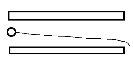

Plates have length 50cm, spacing 1cm, and P.D of 20V. Find minimum velocity of electron such that it just emerge from plates.
##F_{e}=qe##
##E=\frac{\triangle V}{\triangle d}##
F=ma
So I can understand how to find out velocity of electron moving between these 2 plates, by using:
##F=ma##
##a=\frac{F}{m} =\frac{qE}{m}##
##v^2=2as = \frac{2q}{m}Ex##
##v = \sqrt{\frac{2q}{m}Ex}##
where x = 0.01 , E =20 etc. Answer seems to be way too off, which is expected.
How am I supposed to find the 'minimum' velocity though?

You seem to have solved for the vertical component of the final velocity.
How long does it take (i.e., how much time does it take) for the electron to travel from one plate to the other if the initial, vertical component of the velocity is 0?

##S_{x}=u_{x}t+1/2a_{x}t^2 =0 +1/2at^2##
May I ask why is that the vertical component that I found? Isn't it supposed to be the 'overall' final velocity?
And if I only have final vertical velocity, can I consult if I am still able to use ##S_{y}=u_{y}t+1/2a_{y}t^2## where a= 9.8?

For the problem to be solved, you need to solve for both the vertical component and the horizontal component of the final velocity.
In the work you showed in the original post, you have solved for the component in the direction that involves acceleration. So now what about the direction which does not involve acceleration?
What's the maximum amount of time it will take an electron to get from the left side to the right side without touching either plate?
The equation is valid, but you'll likely find that the gravitational force is completely negligible compared to the electric force. So although the equation is fine, no, you wouldn't use a=9.8.
By the way, just for clarity, is there anything left out of the problem statement such as the initial direction of the electron? Does it specify that the electron is initially traveling in the horizontal direction or can it be shot in at a slight angle?
you can study the problem exactly like that of a projectile with initial velocity v (which seems to be only horizontal in our case) inside a gravitational field but instead of ##a_y=g## you take ##a_y=\frac{Eq}{m}##.

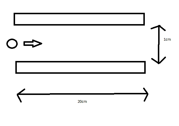

To all:
Electron is assumed as initially traveling in the horizontal direction.
I used spoilers because I thought my attempt is not related to the solution.
So as far as I'm concerned, there is only acceleration due to the electric field in the vertical direction and no acceleration in the horizontal direction.
So my job is to find out the velocity for just the electron to squeeze out from the plates, so something like this? (Pardon my drawing)
Alright so to find the time taken, since initial velocity of the vertical component is 0 (since it is initially traveling in the horizontal direction),
##S_{y}=u_{y}t+1/2a_{y}t^2 ##
where ##u=0##, so,
##S_{y}=1/2a_{y}t^2 ##
where ##a_y=\frac{Eq}{m} ##
So can I assume:
##0.05=\frac{1}{2}\frac{Eq}{m}t^2=\frac{1}{2}\frac{(20)(1.6*10^{-19})}{9.11*10^{-31}}t^2##
So ##t=1.69*10^{-7}s##?
Am I on the right track here?

yes you are definitely on the right track. Now all you need to do is to find the horizontal velocity, such that in the same time t, it travels horizontal distance d=length of plate.

Yes, although why calculate ##t##?
There are only three variables: acceleration, length and width. Time is bound to cancel out if you stick with the algebra.

Won't I need to find t to find out the horizontal velocity? Since I'm determining the velocity needed.
Hmm okay :)
So since ##t=1.69*10^{-7}s ##, and horziontal distance traveled is 0.1m,
##S_{x}=u_{x}t+1/2a_{x}t^2## where ##a_{x}##=0,
##0.1=u_{x} (1.69*10^{-7}s)##,
##u_{x} = 591715.9763m/s##
Since I have ##u_{x}## and ##v_{y}## (##v_{y}=u_{y}t+at= 0 + \frac{Eq}{m} (1.69*10^{-7}s) =594375.4116m/s##
So technically, shouldn't the velocity be ##\sqrt{u_{x}^2+v_{y}^2}## = 838695.3717m/s?
Answer seems to be ##9.38*10^7## instead :/

It's the initial horizontal velocity you are looking for.
You do like your numbers!
At this level of physics, a fear of algebra is a serious if not fatal handicap.

Also, you need to decide what the horizontal distance actually is. You have it as variously 10, 20 and 50cm in your posts.

Correct me if I'm wrong, but won't the initial and final horizontal velocity be the same?
My bad,
Where ##S_{x}= 0.5 ,a_{x}=0##
After doing the same steps as above, I will still get resultant velocity as ##3.02*10^7 m/s##

There is always lots of room for error when you work with complicated numbers with lots and lots of significant digits.
Why not try an an algebraic approach?
The irony is that I've done it algebraically and can see that the length must be ##50cm##. If I'd used your approach maybe I would have got something wrong as well.

jisbon said:
But this equation is correct, right? ##0.05=\frac{1}{2}\frac{Eq}{m}t^2##
0.5 cm ≠ .05 m. This might be the "issue of units" that @PeroK referred to.
PeroK said:
Leaving aside the issue of units, yes.
Hi all, thanks for your help :) The value seems to be alright, but the power is off by ##10^1##, was wondering if anyone of y'all could help figure it out :)
##0.5=\frac{1}{2}\frac{Eq}{m}t^2 = \frac{1}{2}\frac{\frac{V}{d}q}{m}t^2 = \frac{1}{2}\frac{\frac{20}{0.
01}(1.6*10^{-19})}{9.11*10^{-31}}t^2##
## t = 5.33*10^{-8}##
##u_{x}=s_{x}/t = l/t = 0.5/ (5.33*10^{-8})= 9380863.03939..##
##v_{y}=0.5a_{y}t^2 = 0.5 (\frac{\frac{V}{d}q}{m})t^2= 0.5 (\frac{\frac{20}{0.01}1.6*10^{-19}}{9.11*10^{-31}})(5.33*10^{-8})^2 = 0.49894##
So ##v=\sqrt{u_{x}^2+v_{y}^2}=\sqrt{(9380863.03939)^2+( 0.49894)^2} =9380863.03939m/s =9.38*10^6##
Final answer's supposed to be ##9.38*10^7## :/
jisbon said:
##0.5=\frac{1}{2}\frac{Eq}{m}t^2 =##….
Explain how you got the value of 0.5 on the left side. What does this number represent and what are its units?
First of all I don't understand why you calculate ##v_y## you are not asked for that (you are not asked for the magnitude of the vertical component at exit or the magnitude of the velocity at exit), you are asked only to calculate ##v_x##, that is the horizontal velocity with which the electron enters the electric field.
Other than that @TSny was just ahead of me in time :D.
50cm = 0.5m
jisbon said:
50cm = 0.5m
But this equation you wrote ##0.5=\frac{1}{2}a_yt^2##is for the vertical motion. 0.5m is the length of the plates not the spacing between the plates which is 1cm. Shouldn it be ##\frac{1}{2}cm=\frac{0.01}{2}m=0.005m=\frac{1}{2}a_yt^2##??
Oh gosh. Yep I realize my mistake. Kept messing up between the length and width :H
