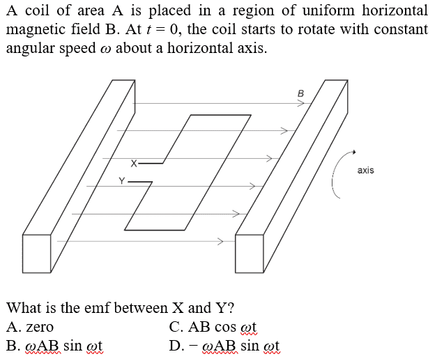

Please see below
emf = - dφ / dt
Diagram of a rectangular coil rotating about a horizontal axis inside a uniform horizontal magnetic field B shown by parallel arrows, with terminals labelled X and Y and the question: what is the emf between X and Y, with options A zero, B ωAB sin ωt, C AB cos ωt, D −ωAB sin ωt.
My answer is (B) but the answer key is (A).
My working:
$$\varepsilon=-\frac{d\phi}{dt}$$
$$=-AB\frac{cos\omega t}{dt}$$
$$=AB\omega \sin \omega t$$
Why the answer is zero? I thought the flux will be zero, not the emf.
How much of the magnetic field ##B## is normal to the area ##A##?
Look at the deifiniton for flux. ##\Phi=(\mathbf B\cdot\mathbf{\hat n})~A## where ##\mathbf {\hat n}## is perpendicular to the plane of the coil. As you say, the flux is zero. You get an induced emf if the flux changes with time. Does it?
Ah I see. Seeing the rotation of the coil with respect to magnetic field, there won't be any B passing through the coil so the rate of change of magnetic flux is zero.
Thank you very much renormalize and kuruman
