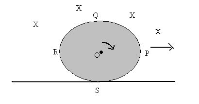

O is the center of the disk
Part a) The emf induced across PS can be found by thinking as if a rod PS is rotating and translating .
The component of velocity of rod perpendicular to its length is vsin45° = v/√2 . The length PS = √2R . Hence emf induced would be B(v/√2)(√2R) = BvR.
Is that correct ?
Thanks

I believe that's right. I assume "due to translation" means to treat the disk as sliding along the surface with speed v with no rotation, while "due to rotation" means to keep the center of the disk at rest and rotate the disk about the center with angular speed ω.

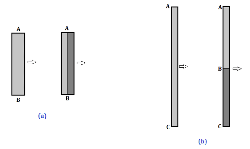

Yes, I believe it's ok to think of it that way. It's like the picture shown below where you have rods moving through a B field into the page (not shown). In the figure on the left, you can think of the emf from A to B of the wide rod as due to two parallel emf's by dividing the rod into two halves as shown. Likewise, in the figure on the right, the emf of the long rod from A to C can be thought of as two emf's in series (A to B plus B to C).
