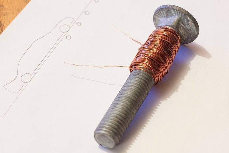

I'm taking physics 2 and was told to create a practical project utilizing electromagnetic force. Starting thinking about Lenz's law (which I just read in a textbook for the first time a week ago) and I thought it would be fun to send a pinewood derby car uphill instead of down.
The sprinkler pump had a bad capacitor from standing water and a lot of other connections were rusted up pretty good. I haven't tested the windings yet but I assume they are okay. The idea is to hook the well pump's coil to a battery and use the induced field to accelerate a magnetic car down a track.
I took the windings from an A/C motor but that shouldn't matter right? I can just hook them directly to a D/C battery? Should I just plug it into the wall? I don't want to start a fire but I don't know my boundaries.
Am I a crazy person? Will this work? Thoughts/criticism/safety concerns/prayers?
See two attached photos of current progress. This is my first post on Physics Forums so I'm not 100% on how image posts work here.
Help or advice of any kind is appreciated, even if it's mean. I understand I'm playing with fire and could seriously hurt myself, so don't don't sugar coat it.

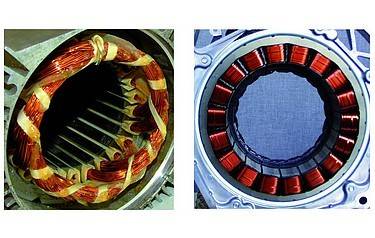

So to propel a small car along a track with magnetic force, you would use coils spaced along the track, not a motor rotor or stator, it would seem...?
The motor stator is just scrap. It's meant to be canabalized and components (already formed insulated copper loops) repurposed. You're right about my inexperience though. I'm not pretending to have it all figured out. That's why I'm doing it! The how is up for debate.
Imagine unrolling a circular stator into a flat stator. Then lengthen it by continued duplication. That will make a moving “carpet” of magnetic field that might drag a conductive plate or metal car along the stator in the same way that an induction motor drags around the conductive armature.
To get the moving magnetic carpet of phase you will need to make AC. That can be two phases at 90°, or it could be three phases at 120°.

Well now I understand. I built a test coil powered by a D battery. It picked up iron things fine, but I'm seeing that overpowering the magnets in the car in an effort to repel them is futile. The magnets will attract to the iron core in the coil and no amount of feasible electricity will move them away. Non-permanent magnet attractants in the car and a system to disable coils seems perfectly logical now that I see it in action.
Realizing I probably won't use permanent magnets in the car being pulled by the emf, what is a good alternative? Nails? Long rods? A flat base on the bottom of the car?

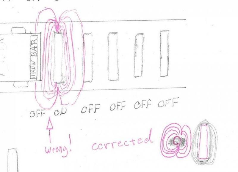

In the second image above I was imagining a bolt core like under the track and pulling in the magnet at each node. So the first electromagnet gives enough momentum to reach the 2nd's field but turning off before the car reaches it and stops. I made one to test with a D battery and it functioned to my delight, even if it wasn't very strong.

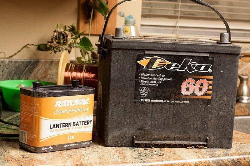

I have two 12v disposable lantern batteries for the real run, and also have access to a 12v 580cca car battery, though I'm skeptical of using it.
I've decided not to use permanent magnets inside the car due to them possibly overpowering the EMF and stopping on the coil cores due to regular magnetic forces. I found some hardened welding steel (realizing non-harded would be more ideal) and am considering using it for both the attractant in the track car and the core for the coils.

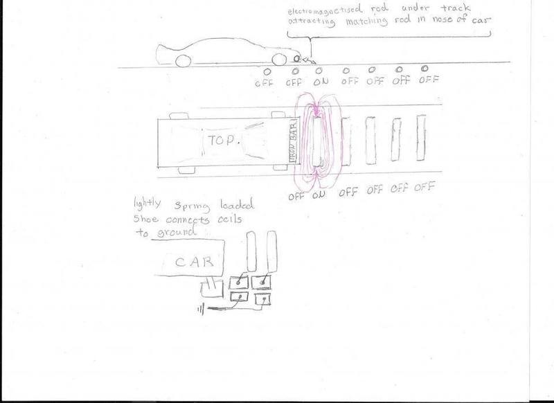

Instead of a bolt sitting directly under the car creating an EMF sucking everything in though the bolt head, I would cut the welding steel to fit in the track sideways with the coil surrounding it. I'm still debating if that's a better idea or worse. Here is my newest design, which I've actually drawn while writing this response:
It incorporates your shoe design, activating the oncoming coils one at a time. My hasty drawing doesn't shoe that process to scale. The rear of the car's shoe would leave the next coil just as the welding rod embedded in the nose of the car reaches it. Still a work in progress but I think this is my best design yet. Since it doesn't incorporate permanent magnets, energizing two coils at a time for both push and pull wouldn't work anymore. That was an excellent suggestion though, and permanent magnets aren't completely off the table. I'm just trying to figure out the best course of action. Hope to make a working prototype over the weekend.
I could have a second shoe and magnetized rod toward the back of the car, offset to trigger at distances midway between the first bar, but far enough away to have no measurable effect on the nose rod. The car is a little over 9 inches long. Maybe I could even do 3 of them. That's a sudden eureka moment just from looking at my own drawing. I love those.

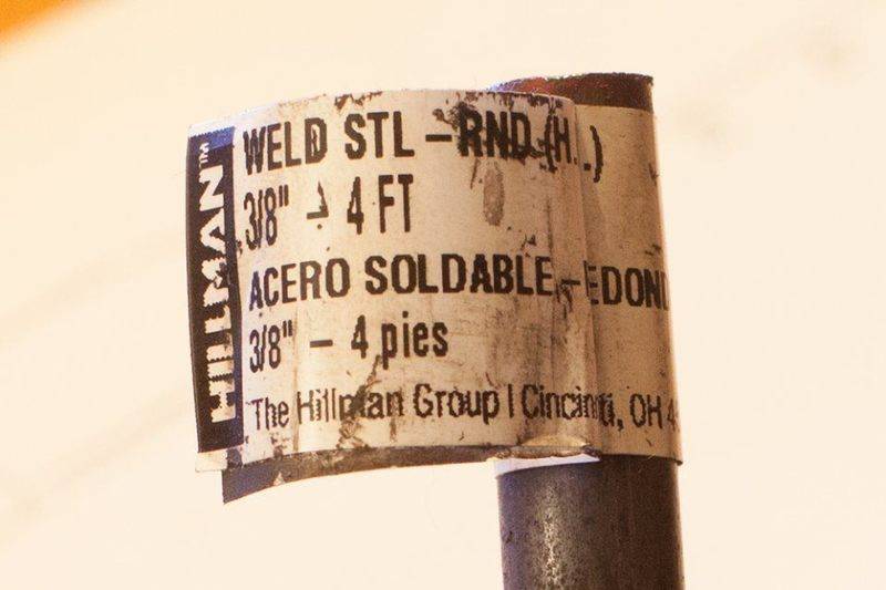

And a brain fart moment. The drawing is wrong. Because the coils are surrounding the welding bar horizontally in the x-plane of track, the induced magnetic field would still flow above and under the track in the y-plane. I had that idea right when I first thought of the concept but drew it wrong in the diagram , then described the diagram as I typed as drawn. That was a big oops, but this is a learning process.
Instead of a straight bar would a U-shaped bar with the poles angled toward the iron bumper of the car be better?
I suppose my biggest grey area is shape, placement, and configuration of the coils.
Activating them at specific intervals and reversing polarity in a NS SN NS fashion seems straight forward enough.

I'm afraid that doesn't make sense. Using a magnet on board means that you can have repulsion and attraction going on at the same time, which is why electric motors are made that way. There is no disadvantage in this. Your ideas about "EMF" are not valid (I don;t actually understand what you are worried about there).
Having two shoes and a more complicated set of contacts could be a distinct advantage and modifications could be made retrospectively.
Again, this means absolutely nothing to me. You don't "suck" EMF. It's not like that. You have a problem here, if you know very little about Electromagnetism and you must avoid jumping to conclusions, as you seem to be doing. It will waste your time. The relatively simple ideas which your early diagrams (and my crude one) are quite enough to get a result, as long as you can build the thing (the biggest problem for many people. :smile:).
Things to remember:
1. A magnet in the car is the only way to get good propulsion. Iron just gives attraction, which is not good enough.
2. More than one shoe could improve the timing of the propulsive pulses.
3. Study the 'logic' of the switching with diagrams. A movable strip of paper, with the magnet and brushes drawn on it and a row of coils for it to move past should be easy to arrange and would give you a good model. All you need to remember is that NN and SS will repel and NS and SN will attract. (Stating the obvious but a strict rule to apply)
4. A Car battery would be a good source of power BUT it is essential that you use a FUSE in series with it or you could easily have a good old fire on your hands. A car battery is virtually an INFINITE source of power. Be prepared to use up a lot of (say 10A) fuses in your tests.

My way of thinking was like a junk yard magnet crane. Instead of a single crane attracting some iron and moving it, there would be a series of cranes very close together attracting some iron but letting the next one down the line take over before it actually connects. There would only be a pull, no push, and the ride would probably be jumpy, but I thought it would work. I was jumping to conclusions, like you said though. Experimenting with magnets now.
A crane doesn't need to move things. A motor does. Think about the way a motor works and extend it to linear motion. A successful motor uses Magnets (electro or otherwise) for both rotor and stator. Trust me. (No one on PF will disagree - if they're reading)
If you can find a single simple motor diagram on the web that does't use magnets, I will be gobsmacked.

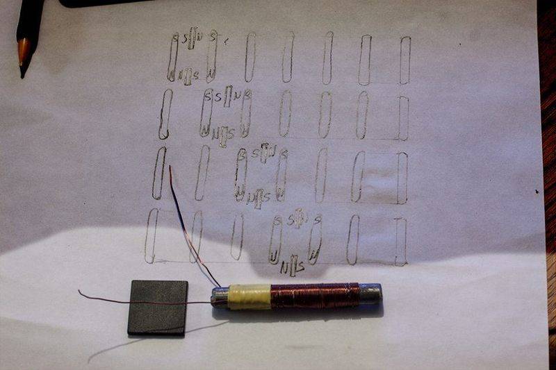

I don't think this is what you are saying but this was my logic. *I don't think this will actually work because what is going to move the magnet from one side to the next unless the electromagnets are super strong? Originally I thought they would be but now I'm not so certain.
I'm going to try to draw something better right now.
I'm going to think about it some more. Actual magnet and coil pictured, drawing artificially darkened to improve clarity
Each row is a representation of time when the permanent magnet crosses an electromagnet
Electro magnets would be switched "off" and back "on" the moment the permanent magnets pass over.
I have physical movement of the car in both directions from a single magnet, so that's neat. Still a lot of work ahead but I have real tangible baby steps.
