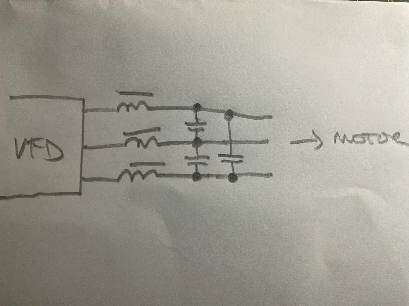

1. In-line chokes, such as old fluorescent light ballasts, providing they could take the rated current?
2. Keep the VFD-motor cable short, and manipulate the VFD’s carrier frequency based on this length?
3. MOVs, or something, to clip the transients? I looked into the surge protection devices (SPDs) now becoming more readily available because they’re mentioned in the new UK domestic mains wiring regulations, but they are apparently not sensitive enough.
4. Some sort of snubber network at the motor terminals?

Not at the motor terminals, but at the inverter output. The voltage switching outputs need to see an inductive load. Wind three inductors on separate ferrite cores, one for each line, then couple them to a delta of pulse rated capacitors, giving three lines with limited dv/dt. A good VFD should have that circuit in its output to reduce radiated EMI.
You could also neutralise the motor power factor with a delta of capacitors at the motor terminals. That would be OK for fixed frequency operation, but difficult if you used a wide range of VFD frequencies.

So this would be a dv/dt, or perhaps LC filter, rather than a snubber?
What sort of values would work? Elsewhere it’s been suggested 5mH and 0.47uF. I’ll need a meter that measures inductance, unless I can just buy suitable inductors. I don’t mind spending a bit, since they’d be protecting essentially irreplaceable motors.
The carrier frequency of one of my VFDs can be adjusted from 1-15 kHz, default 3 kHz, if that’s relevant.
How would correcting the motor pf (which you helped me with before) deal with VFD voltage spikes?

It would better isolate the motor inductance from the VFD. Correctly chosen capacitors across the motor will limit dv/dt, and reduce circulating current between the motor and VFD, that might otherwise saturate the VFD output chokes.

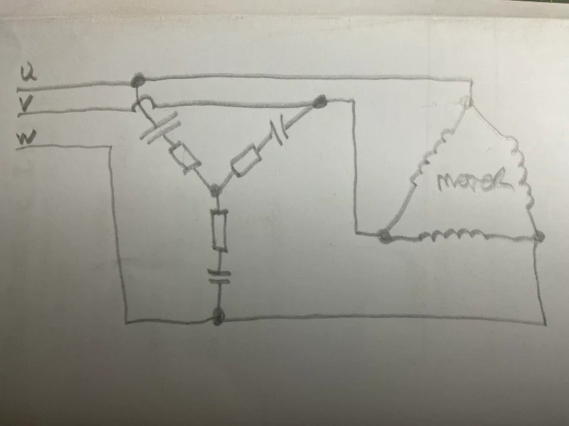

I was leaning towards an RC snubber at the motor terminals, because I probably have the components already, and none of them have to take the full motor current. This means I should be able to make the same snubber for all motors that need it.
In either the RC or LC case, I wondered if the capacitors should be X2 rated, since they’re across the mains, and should be designed for this?

A snubber would reduce dv/dt of the voltage spikes. What circuit would you use for snubbers?
Something like this?:
I’m not sure if the star point of the snubber should be earthed; all circuits in my shop are RCD-protected to 30mA so I’d like to avoid earth leakage.
I’m also not sure of values, but assume that they’re not so critical, because of the wide gap between desired (<=100 Hz) and undesired (>3 kHz) frequencies.
If possible connect the Y of snubbers mid-point to the neutral, avoid a ground connection. If no neutral, design delta a snubbers, or leave the centre floating.

I have a small box of X2 capacitors, rated for 310 Vac and 0.47 uF, which I used to fit into vintage valve (tube) radios when restoring them.
Starting with this 0.47 uF value, and a -3 dB cutoff frequency of 2 kHz, the Digikey RC filter calculator (https://www.digikey.co.uk/en/resour...sion-calculator-low-pass-and-high-pass-filter) suggests a resistor value of 169 ohm. No comment on the power rating - would it be of the order 1, 10 or 100W?
Guineafowl said:
Starting with this 0.47 uF value, and a -3 dB cutoff frequency of 2 kHz, the Digikey RC filter calculator suggests a resistor value of 169 ohm.
You do not want any resistance in the path of the current to the motor. A snubber would use a series RC circuit, but not an LPF.
For a 3PH LPF you could use inductors to a delta of capacitors, then the motor. Maybe 5mH and 0u47.

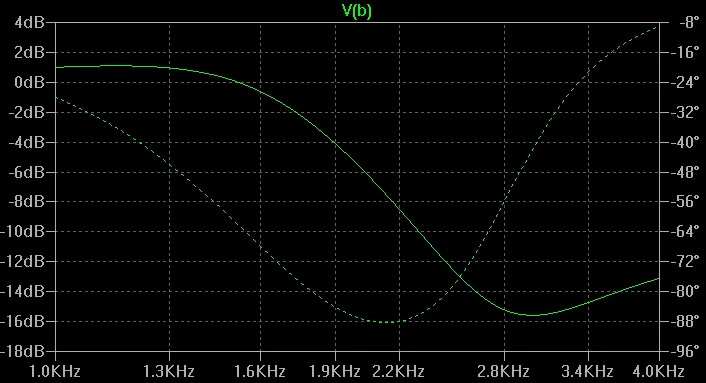

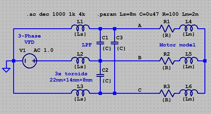

Here is a crude first guess at what you need.
It has max attenuation at VFD 3 kHz, 0 dB at 50 Hz.
The motor model is a guess, now configured as Y.
Toroids wound for 2 amps, 8mH, wound by the datasheet numbers.
VFD is an AC model, so is a zero impedance voltage source.

Thanks - I see the difference between an RC LPF and the snubber.
I’ve ordered a 20-pack of ferrite rings at those dimensions, and have found my LCR meter.
What I could do with, is a cheap way of measuring THD before and after installing the filter, is that right? I found this:
https://owen-brothers.com/ob975-rogowski-panel-meter.html
The aim is to remove the sharp steps from the waveform. That will prevent reflections in the cable, and reduce vibration of the motor windings.
Do you have part numbers on the toroids, and a link to the datasheets? The inductors need to carry a couple of amps without saturating. They also need sufficient turns to give 8mH. The 22x14x8mm toroids appears to be the smallest that will satisfy the requirements.

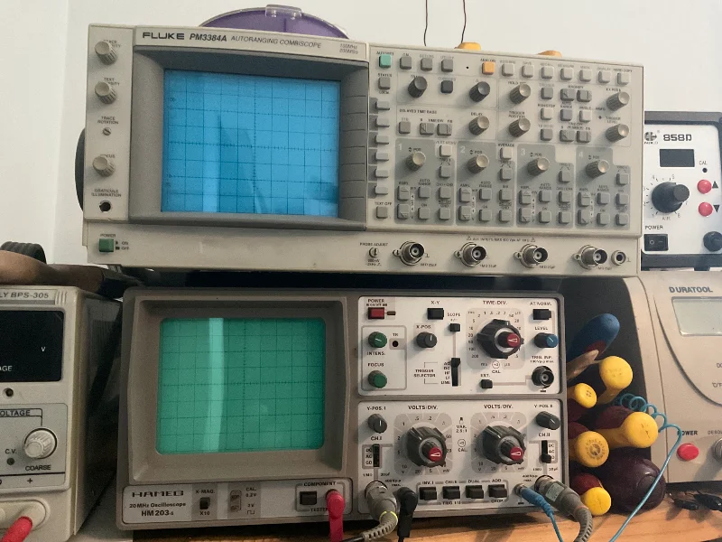

I have a Hameg HM203-5 20 MHz CRO, and a Fluke/Phillips PM3384A 100 MHz combiscope, but the digital part doesn’t work. Also, some ordinary 100 MHz probes. I assume I’ll need some better kit.
I’ve been looking at some of the Rigol/Hantek digital offerings. But would I need some special probes?
Bandwidth or not critical, 1MΩ and 1MHz are sufficient, but the probes should have a x10 voltage switch on them, which also changes them from 1MΩ to 10MΩ impedance.
On the X10 range, the probes can be neutralised with a screw adjustment in the handle of the probe. That is what the 1 kHz square wave test point on the oscilloscope is used for.
Don't disconnect the probe BNC connector from an oscilloscope, or move the X10 switch, while the probe is connected to high voltage.

You need to read and understand the manual.
It looks like the Hameg HM-203 has a button to "Invert 1", and a button to "SUM", at the bottom of the panel. That gives you subtraction of the two channels.
I believe the Fluke PM3384A has the necessary switching to make some 3PH observations. You will need to investigate the operator's manual further.

Yes, it’s been two house moves since I last saw the Hameg manual. As I remember it, the ADD/CHOP button selects dualling options:
ADD: alternate sweeps for 1 and 2
CHOP: switches between 1 and 2 during each sweep.
Will update when I dig out the manual. I’ve never had one for the Fluke.

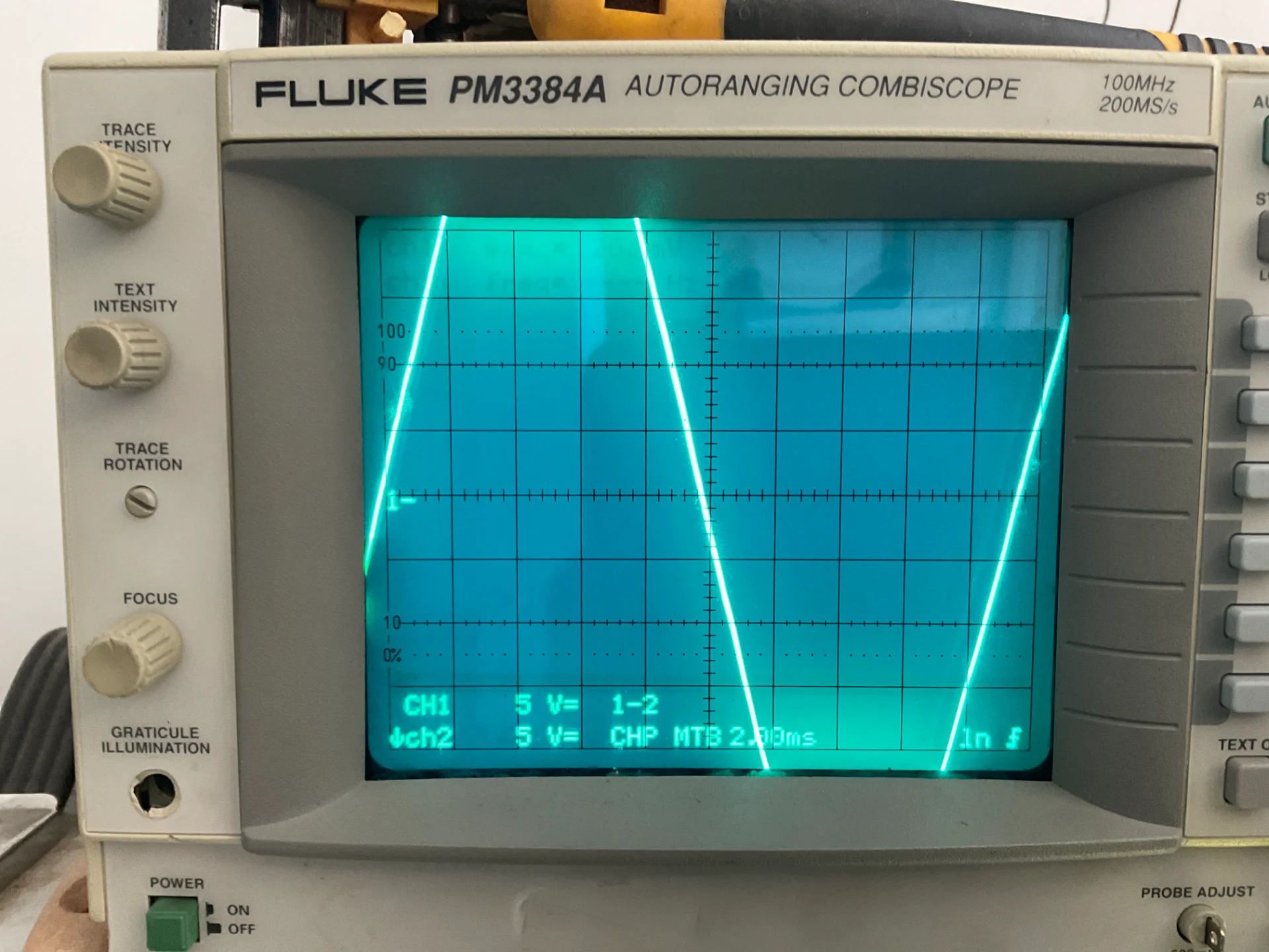

Here is a scope shot of the normal mains. CH1 and CH2 probe tips on L and N respectively. Trace displaying CH1-CH2. Line trigger. If I move the trace up or down, I can see the peaks.
If possible, switch the probes to x10, then neutralise them to show a square wave while the probe is connected to the probe adjust terminal on the front panel.
