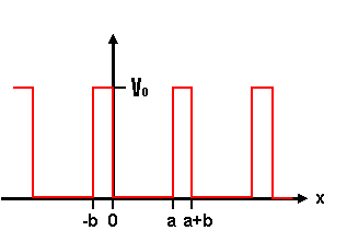

I've calculated that alpha=4.78x10^9. I understand that a Delta function is a periodic potential much like this one...
Kronig-Penney potential: a periodic square-well potential with barriers of height V0 and width b repeating along the x-axis, with positions -b, 0, a and a+b marked.
...EXCEPT that V0 --> infinity, b --> 0, but bV0 still has a finite area.

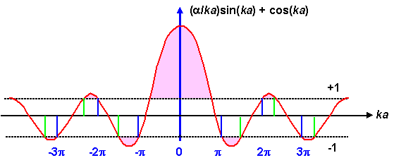

I can see that plotting the left-hand-side of the equation given in the question against (alpha x a) will result in this graph:
Plot of (alpha/ka)sin(ka) + cos(ka) against ka, a red oscillating curve with peaks at 0 and at multiples of pi, lying between dashed lines at +1 and -1; the central peak region is shaded pink, and green and blue markers sit at the band edges around -3pi to 3pi.
And I understand that for the equation to hold true, the left-hand-side cannot go above 1 or below -1, hence the regions shaded pink in the above plot are invalid solutions of the equation in the question.

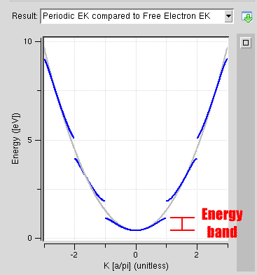

I understand that what I am looking for is the energy band marked here:
Plot of energy in eV against K in units of a/pi for a periodic potential compared with free electron energy; blue bands sit on a grey parabola, with gaps at K = ±1 and ±2, and a red annotation labels a lower energy band.
But I just don't know how to get it.
I understand what the question is asking, what the concepts mean, but I'm just lost in the mathematics.
As I said, any help would be greatly appreciated. :smile:
Cheers.
For the delta 'function' periodic potential, the Energy(E) versus Wavenumber(k) lies above the free particle parabola. So, the first band stretches from the global minimum of E(k) to the first intersection of E(k) with the parabola. You have all the information you need to work this out now.
