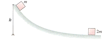

A package of mass m is released from rest at a warehouse loading dock and slides down a 3.0-h frictionless chute to a waiting truck. Unfortunately, the truck driver went on a break without having removed the previous package, of mass 2m, from the bottom of the chute.
a) suppose the packages stick together. what is their common speed after the collision?
b) suppose the collision between the packages is perfectly elastic. to what height does the package of mass m rebound?

v = [tex]\sqrt{}2gh[/tex]
v = 58.8m/s, this is the velocity at which the box 1 hits box 2
From this point i decided to use momentum to find the final velocity
(2m+m)vf = mvi
This simplifies to 3Vf = V/3 = 19.6m/s

You forgot the square root.

Using conservation of kinetic energy for the first problem will give you a different answer than conservation of momentum. You can't use conservation of kinetic energy here because kinetic energy is not conserved. The collision is inelastic.

so, for all collisions momentum is conserved.
for elastic collisions momentum + KE is conserved
for inelastic collisions momentum is conserved but KE isn't
so the square root of 58.8 = 7.668m/s
and the final velocity of boxes stuck together is 2.56m/s
Whoa! That doesn't conserve momentum.

Looks good to me. Now solve part b).
alright for the next part we have perfect elastic collision
Ek = conserved
P = conserved
This is my first equation for Momentum:
m1v1+m2v2 = m1vf1+m2vf2
This is my 2nd equation for kinetic energy
1/2m1v12 + 1/2m2v22 = 1/2m1vf12+1/2m2vf22
This should take some algebra :sLooking into my textbook I found these simplified equations
Vf1 = Vi*(m1-m2/m1+m2)
For this part I found that the Vf of the first object = -2.56m/s
Vf2 = Vi*(2m1/m1+m2)
For this part I found that the Vf of the object = 5.11m/s
It checks out - momentum conserved, energy conserved.
Also did it without the simplified equations and got the same answers.
