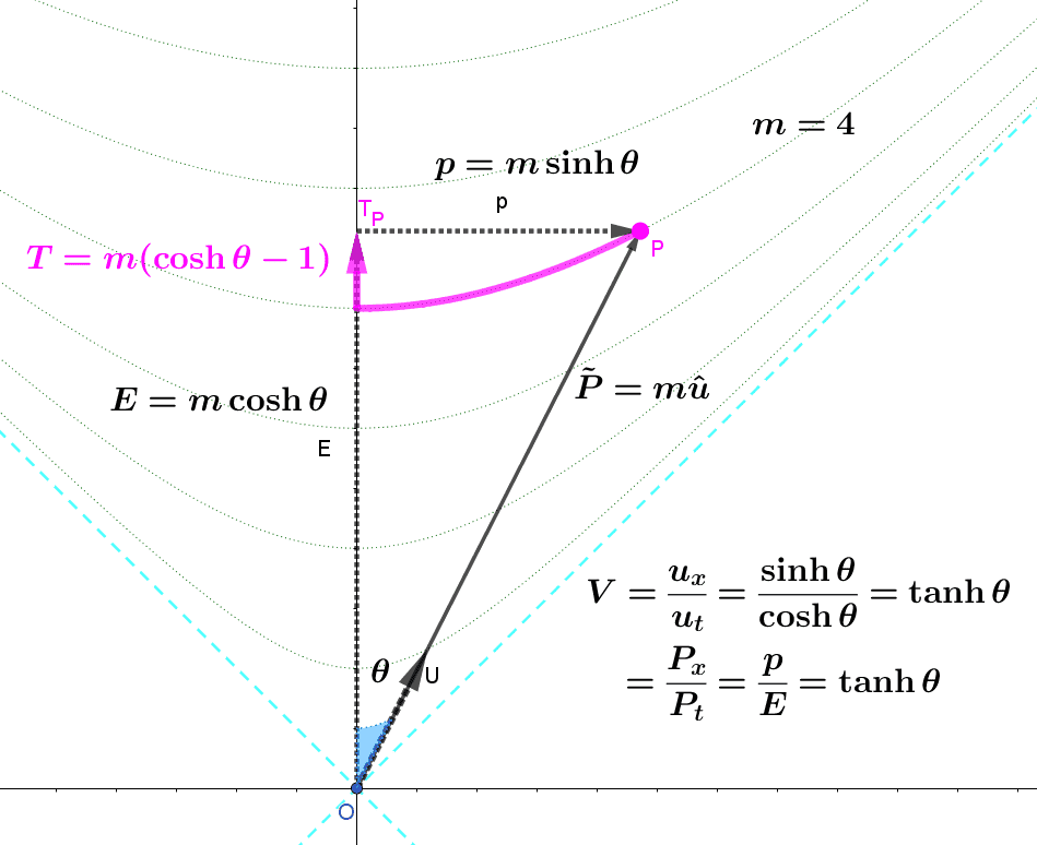

Here's an energy-momentum diagram from my answer on
https://physics.stackexchange.com/q...al-in-a-spacetime-diagram-relat/551250#551250
To see this geometry applied to a more complicated situation,
visit https://physics.stackexchange.com/a/510201/148184
and https://physics.stackexchange.com/questions/594212/momentum-diagram-for-two-colliding-particles
