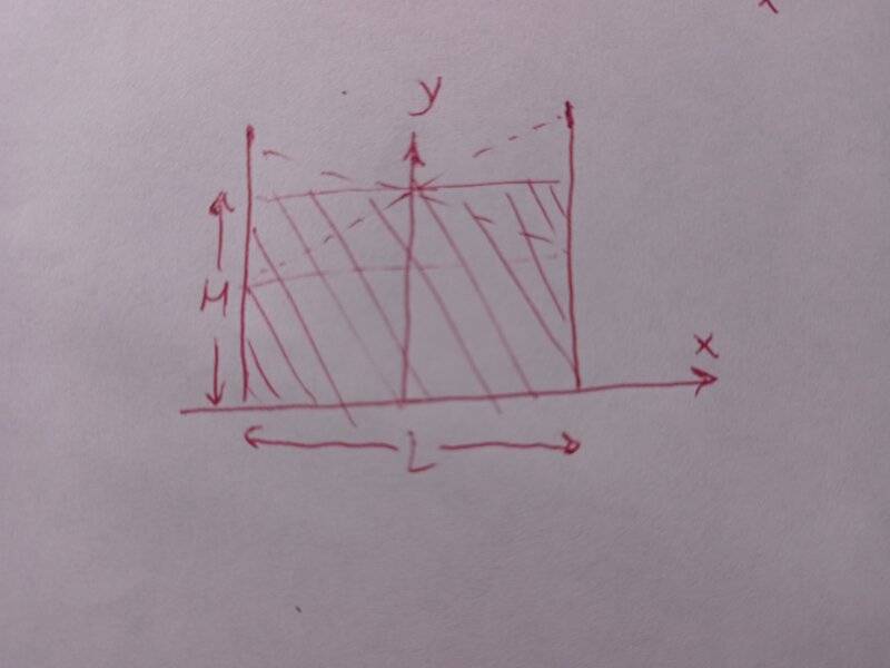

in container with dimensions L×D, rests water of height H and density ρ. we disturb the water along L dimension, and accept an oscillation is caused on the free surface of the water, which maintains its flatness, so that the central of mass of the water moves up-down and left-right, and the water does not move in the extreme positions but only has change in potential energy due to gravity, while in the middle positions where the surface is horizontal, all the energy gets converted to kinetic energy. say the central of mass is in position ##(x_o,y_o)## in equilibrium, and ##(x,y)## during the oscillation. how do we show that ##mg(y-y_o)## is proportional to ##(x-x_o)^2##, and find cyclic frequency of the oscillation of the water?
i have tried to prove said proportionality using conservation of energy as follows: for every column of height ##(H+a)##, it is ##dm=σ*a*dx##, and ##m=σ*L*H##, where ##σ=ρ*D##. also, let K be the kinetic energy and U dynamic potential energy. then, ##K={1 \over 2 }*m*u^2##, ##U=mg(y-y_o)##. because ##{dE \over dt}=0## (we assumed we have simple harmonic oscillations) and ##E=K+U##, we find that ##(y-y_o)~u^2##. the main problem here is what assumptions would i be correct to make about the relationship of ##(x-x_o)## and velocity u? how would i compute frequency?

Can you upload a diagram of this scenario? Use the "Attach files" link below the Edit window to upload a PDF or JPEG diagram.

hello, i am new here and I don't know much about the site yet, thank you for information. it is a question my professor gave in the last lecture. i will upload the diagram shortly.

I have doubts about the validity of the model. Seems to make the assumption that at any instant all the water at a given horizontal displacement from the centre is moving with the same horizontal velocity. But in reality, as H increases, there is less movement at depth.
Glossing over that, consider a vertical slice through the tank, width dx, displacement x from the centre line. Let the angle of the surface be ##\theta(t)##.
In terms of ##\dot\theta## etc., can you get an equation for the velocity of the water in the slice?

We know (or can easily show) that if the tank accelerates with constant acceleration ##a## along a straight line, the fluid level will be inclined at angle ##\varphi## relative to the horizontal given by $$\tan\varphi=\frac{a}{g}.$$ We are told that the water surface "maintains its flatness" throughout the motion. Therefore it is safe to assume that each intermediate inclination corresponds to an intermediate acceleration. So we can model this as having the tank oscillate horizontally with frequency ##\omega## and amplitude ##A##.
Then the tangent of the maximum angle of inclination is $$\frac{y_{\text{max}}}{L}=\tan\varphi_{\text{max}}=\frac{a_{\text{max}}}{g}=\frac{\omega^2A}{g}\implies \omega^2=\frac{g\,y_{\text{max}}}{AL}.$$ Now to find ##A##, I think it is safe to say that at ##x=A## the gravitational potential energy change of the fluid of mass ##m## from the equilibrium rectangular configuration to the non-equilibrium trapezoidal configuration is equal to ##\frac{1}{2}m\omega^2A^2.##

My idea was to find the KE of each vertical element as a function of ##x, \theta, \dot\theta## and integrate to find the whole KE. The GPE is a simple function of ##\theta##, so energy conservation gives an ODE in ##\theta, t##.
However, for the whole KE I am getting an expression involving ##\ln(H+L\tan(\theta)/2)##.
We could make a small angle approximation, but it still doesn’t look promising.

It corresponds to an intermediate constant acceleration, yes, but does it work for a varying one?
We are told that the surface maintains its flatness. I think that this is a hint to assume that the surface inclination adjusts instantly to the acceleration as it varies from zero to a maximum value. If the tank executes simple harmonic motion, we have the acceleration and hence the angle as a linear function of position.

With a surface angle perfectly adjusted to one horizontal acceleration, the water is at its lowest potential. If that acceleration changes, it is no longer at lowest potential. The readjustment releases energy which will persist as slop.
I don't read it as the hint you suggest.
It seems clear that the answer will have the form ##\omega=f(H,L)\sqrt g##. The density will be irrelevant.
Provided ##L<2H##, I suspect the answer would not differ greatly from that of a solid semicylindrical body rocking back and forth in a smooth cylindrical channel of diameter L.

With the surface at angle ##\theta##, what is the net force exerted by the end walls? What relationship does that give between the horizontal displacement of the mass centre and its horizontal acceleration?
Edit: @charie, were you able to get an answer using the above?
