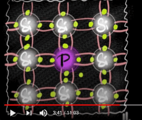

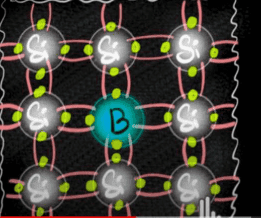

Which are the factors which set the donor or the acceptor level in a semiconductor?
How can we calculate the energy of a hole or an electron in p and n type semiconductors?
Which are the contributions from different sources we must take into account? I know it is the dopant and base but if we change one of them how that changes it ? Maybe the interatomic distance has something to do with it?
It's not the interatomic distance, it's the number of valence electrons. Silicon has 4 valence electrons, so they are all used up bonding to the neighboring Si atoms. So pure Si has basically no free electrons, except for the very few that are thermally excited. Phosphorous has 5 valence electons, so when you replace a Si atom with a P atom, there is one extra electron that is not bonded, and so is free to move about the lattice. Boron has 3 valence electrons, so when you replace a Si atom with a B atom there is one electron missing, which acts as a "hole" or positive charged carrier that is free to move about the lattice.

If I understand this thread correctly, you seek a method to predict the levels of a dopant in a host.
This is exactly what computational materials scientists/physicists do. The gold standard in this field is using density functional theory simulations to predict the energy levels of a dopan in a semiconductor.
This is a very vast and well-established field. See for example Fig. 2 in this paper that shows the density of states of ZnO (semiconductor) doped with Lithium
https://d1wqtxts1xzle7.cloudfront.net/45595590/Ferromagnetism_in_Dilute_Magnetic_Semico20160513-9274-ixj6en.pdf?1463136126=&response-content-disposition=inline%3B+filename%3DFerromagnetism_in_Dilute_Magnetic_Semico.pdf&Expires=1614027465&Signature=T0GgM0Ppv51duxX7--RcPohkXd2ddnzRxLNZtgwVQr1-dd0O79TzlQEpQ~-MqzTxGnIme0OYNBDL6iGEuvb1WPv7JreAZXgGgS8EwquIZA5EA2vvNyKytd9gSyhs6Zt~wqTBaSCccMNce8xVF4aENS7a4vLPvKQXLQGcvYIHEr7oTmwxsiwR3zcwlftT4kPLFJfEuPtguugmjvbmcKS33sOrBtKqDXYYlez6cekcpPCagJHXjTket~-KGfa1E3ZtbxmuysjI8TZqSYvJKV2BiQ6rFknOyUj3x0VvNUkB1vIMXWG6bnvNq7kZnjWINpwqepd~~NzpLyNZDzg8Iq5CHQ__&Key-Pair-Id=APKAJLOHF5GGSLRBV4ZA
If you want to get into this field, you will need to study some materials science, solid state physics, and thermodynamics.
