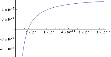

Hi,
so I tried out the suggested corrected coulomb potential, but it doesn't seem proper and I cannot see what I'm doing wrong.
my definition goes like this (using cgs gauss units as in the paper, I'd presume, because of alpha=e^2/(hbar*c)):
Code:
e = -4.80320451*10^-10 statC
m = 9.10938291*10^-28 g
hbar = 1.054571726*10^-27 erg*s
c = 29979245800 cm/s
alpha = e^2/(hbar*c) = ~1/137
qftCorrection[r] = 2*alpha/(3*Pi) * Integral[Exp[-2*(m*c/hbar)*x*r] * (1 + 1/(2*x^2)) * (x^2 - 1)^(1/2) / x^2, {x, 1, Infinity}]
coulombEnergy[r] = -e^2/r*(1 + qftCorrection[r])
pairEnergy[r] = 2*m*c^2 + coulombEnergy[r]
The main problem is that the energy for the electron/positron-pair (pairEnergy[r]) drops below 0 (which it shouldn't, right?) for distances smaller than around 2*10^-13 cm as can be seen in this plot.
Is there possibly some error in the units I'm using or did I misinterpret the formula somehow ?

The minimum radius of positronium (its radius in its lowest energy state) is of order the Bohr radius, very roughly ##10^{-10}## meters. Thus it always has positive total energy, because this is much greater than the radius you calculated at which the negative binding energy would exceed the positive rest mass energy of the constituents.
However, it seems to me that if you increased the charge of the electron enough, then you could make it so that the total energy of the positronium ground state would be negative. I'm unclear what this means--does the vacuum turn into a condensate of e+e- pairs or something?
