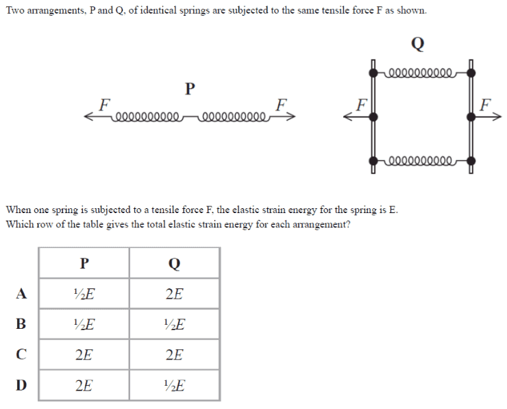

Please see below
F = kx
##E = \frac{1}{2}kx^2##
For P, the force will be 2F and the spring constant will be ##\frac{k}{2}## so the extension will be 4 times, and the energy will be 8E but there are no options showing 8E
What is my mistake?
How do you arrive at that?
The problem pretty clearly states that force is F, not 2F.
My hint for this problem would be to consider the forces on each constituent spring individually and then add up the energies. It makes things so much easier.
I thought since there are two F in the diagrams, it means the force acting on the system is 2F. But it seems I misunderstood the question
Tension is not a force, exactly, but a pair of equal and opposite forces. Likewise compression.
If a static rope is pulled by a force F at one end then it must also be pulled by F at the other.
What we say is the magnitude of the tension is a matter of convention, namely, that the tension is F. It could have been defined as 2F, but it isn’t.

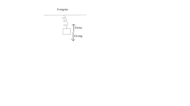

I'm not OP but I'm having trouble with this as well. Here are my attempts at answers to your questions:
1. Assuming the spring constant is ##k## and its length is changed by ##x##, then the tensile force is ##kx##.
2. The spring is said to be ideal (massless) so it's nonsensical to ask what force acts on it?
3. This one I can't answer. If I had to guess I'd say it would be the weight of the object, plus ##kx## (because the string is pulling down from the ceiling).
4. Sorry for the low quality image
You were not given the spring constant nor the extension of the spring.
No. That an object is massless does not mean no forces can act on it. It means the net force must be zero.
Try Newton’s second law …
This is not a free body diagram of the spring, as has been pointed out.
Thanks. Concerning the original problem, the correct answer is
D
, right?

Yes
songoku said:
There are 2 forces: downwards from the mass and upwards from the ceiling, both have magnitude of mg
Is that correct?
Yes, that is correct. Now compare that free body diagram to the figures in your original post. (Just turn them 90 degrees)
I understand.
Thank you very much haruspex, Orodruin, DrBanana, Steve4Physics
songoku said:
I understand.
P arrangement:
The force F acts along the string that links both springs. So, there would be a force F acting on Spring 1, and the same force acting on Spring 2.
Therefore, both springs would be elongated the same distance x, as just one spring would be elongated if a force F is applied to the spring.
So, each spring would have an energy E, and the P arrangement would have an energy equal 2 x E.
Conversely, and following a same line of thought, Q arrangement is going to end up with energy equal 0.5 x E.
You can deduct which is the correct answer to your homework.
