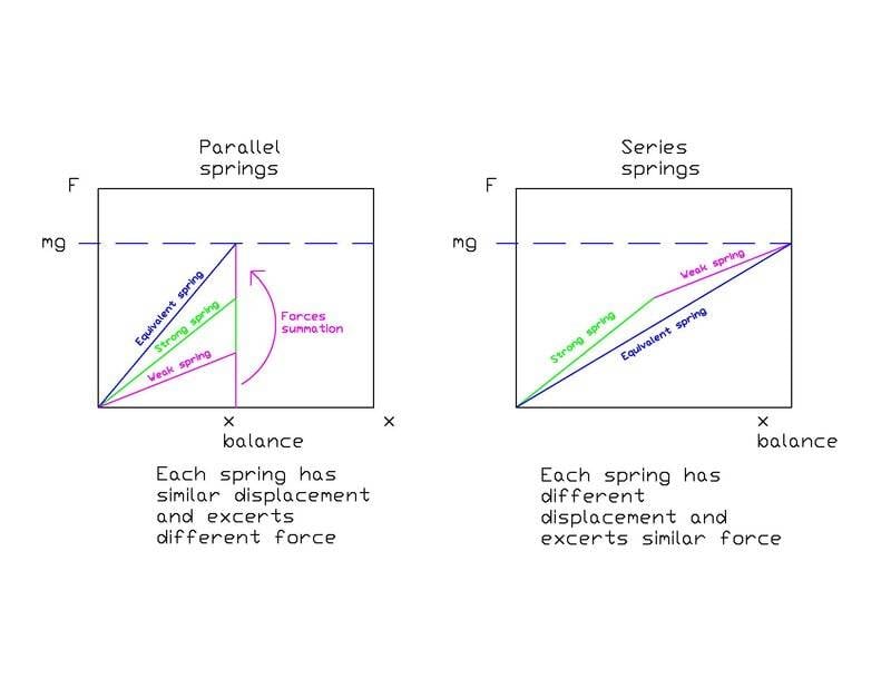

flinnbella said:
Ok I get that the total displacement of the mass is delta_x + delta_y, and this can be represented by a single spring instead of two. However, I don't see a relationship between the spring constants.
Note how much you can stretch two rubber bands (in parallel) at once.
Now, tie two ends of those bands (in series) and stretch both as one.
At the point that you are applying similar force as before, there will be much more stretching (x of balance) for the second case.
  • #39
Oh this makes some more sense, not 100% understanding but it helps. How did you make the graphic?
  • #40
What is still unclear?
Left graphic:
Balance load equals mg.
Both, the strong and the weak spring, must deflect the same in order to produce a combined reactive force equaling mg.
Reactive individual force of strong spring is greater than the reactive individual force of weak spring, but summation of both is the balance load mg.
Could you try describing the right graphic?
  • #41
Left graphic:
I don't see why the springs both exert a force of the mass. Spring 2 exerts a force because it's attached, but spring 1 isn't directly connected to the mass so how can it apply a force to the mass? Makes no sense.

  • #45
What prevents spring 2 to fall down to the ground, together with the attached mass, is a force of magnitude mg pulling them up.
The net force on that spring 2 is then zero, and it remains in balance.
Exactly the same thing happens to spring 1 (which is attached to ground and to spring2-mass).
