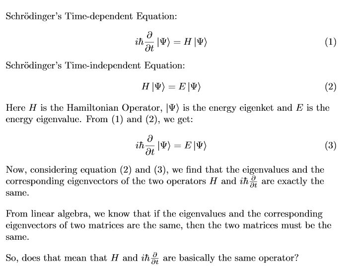

@arpon please use LaTeX and ordinary text in your posts, instead of an image. The image makes it impossible to quote portions of your post. Help on the PF LaTeX feature can be found here:
https://www.physicsforums.com/help/latexhelp/
The answer to your question is no, they are not the same operator. Your equation (3) is wrong because it takes a time-dependent equation, (1), and equates it to a time-independent equation, (2). That's not valid.

I find it best when discussing Schrödinger's Equation to use uppercase ##\Psi=\Psi(x,t)## to capture the entire space-time behavior of a system, and lowercase ##\psi=\psi(x)## to denote the spatial behavior of a system at a particular time (possibly with a subscript, ##\psi_t##, to incorporate a specific time in the label of the function).
When we talk about operators corresponding to observables in the standard Quantum Mechanical formalism, we are really talking about operators on the ##\psi## functions, which form a Hilbert Space. The ##\Psi## functions, on the other hand, do not form a Hilbert Space, and operators on that space do not represent observables.
In other words, an operator like ##E:=i\hbar\frac {\partial}{\partial t}## acts on the ##\Psi## functions and is a completely different object to one like ##H:=\frac {d^2}{dx^2}## which acts on the ##\psi## functions, and so you can't compare them directly.

Can't ##H:=-\frac{\hbar ^2}{2m} \frac{\partial ^2}{\partial x^2} + V(x) ## act on ##\Psi (x,t)## as well?Physics Footnotes said:In other words, an operator like ##E:=i\hbar\frac {\partial}{\partial t}## acts on the ##\Psi## functions and is a completely different object to one like ##H:=\frac {d^2}{dx^2}## which acts on the ##\psi## functions, and so you can't compare them directly.

To the OP:
As you write, Eq 2 is true only if ##|\Psi \rangle## is an energy eigenket.
In contrast, Eq 1 is true for any ##|\Psi \rangle##. For example, in Eq 1, ##|\Psi \rangle## can be a sum of energy eigenkets.

Yes. I just wanted to show that the energy eigenkets are also eigenkets to the operator ##i\hbar \frac{\partial}{\partial t}##.atyy said:To the OP:

arpon said:Yes. I just wanted to show that the energy eigenkets are also eigenkets to the operator ##i\hbar \frac{\partial}{\partial t}##.
But eigenkets of ##i\hbar \frac{\partial}{\partial t}## are not necessarily eigenkets of H.
For example, you can write the full time-dependent Schroedinger equation (your Eq 1) with several different Hamiltonians (eg. Hamiltonian for the simple harmonic oscillator or Hamiltonian for the hydrogen atom). The eigenkets of each Hamiltonian will be eignekets of ##i\hbar \frac{\partial}{\partial t}##, but eigenkets of the simple harmonic oscillator are not eigenkets of the hydrogen atom.

Isn't the Hamiltonian Operator in the Schrödinger's time dependent equation is the Hamiltonian operator defined for the particular system we are considering?atyy said:For example, you can write the full time-dependent Schroedinger equation (your Eq 1) with several different Hamiltonians

atyy said:Do you know how the "separation of variables" where you get from the time-dependent Schroedinger equation to the time-independent Schroedinger equation?
Letatyy said:But eigenkets of ##i\hbar \frac{\partial}{\partial t}## are not necessarily eigenkets of H.
$$\Psi(x,t) = A(t) \psi(x)$$
Applying Schrödinger's Time dependent equation:
$$\begin{equation}
i\hbar\frac{\partial}{\partial t}\left(A(t)\psi(x)\right) = H\left(A(t)\psi(x)\right)
\end{equation}$$
Let ##\psi(x)## is an eigenfunction of ##H## with eigenvalue ##E##. So, we get
$$\begin{align}
i\hbar\frac{d}{dt}\left(A(t)\right)\cdot \psi(x) = EA(t)\psi(x)\\
\implies i\hbar\frac{d}{dt}\left(A(t)\right) = EA(t)\\
\implies A(t) = e^{-\frac{iEt}{\hbar}}\\
\implies \Psi(x,t) = \psi (x) e^{-\frac{iEt}{\hbar}}
\end{align}$$
So, the general solution is
$$\Psi(x,t) = \sum \psi _n(x) e^{-\frac{iE_nt}{\hbar}}$$
But the eigenfunctions (of the Hamiltonain operator) ##\psi(x)## are not the same for different systems (i.e for different ##H##).

@bhobba (my fellow Brisbaneite!), nothing I am saying contradicts standard textbook QM. I am simply choosing a more mathematically careful way of using our ubiquitous ##\psi## friend in two different ways: first in a concrete version of Schrödinger's Equation, considered as just a partial differential equation, and second as a function/vector in a Hilbert Space, corresponding to the more sophisticated and abstract treatment of QM. Maybe a simple example will help clarify.
Consider the following two expressions:
$$\Psi (x,t):\mathbb R^2\ni (x,t)\mapsto e^{-iEt}\phi(x)\in \mathbb C$$ and $$\psi _t(x):\mathbb R \ni x \mapsto e^{-iEt}\phi(x)\in \mathbb C$$
The first function represents a solution to Schrödinger's Equation, but being a function of two variables (configuration space and time) it is not what we mean by a 'quantum state', or a 'quantum wavefunction', since it contains the full space/time dependence; a state is something corresponding to a particular instant in time.
The second expression is a function of one variable, ##x\in\mathbb R##, for any specified instant ##t##. Moreover, for any given time ##t##, this function is a square-integrable element of the Hilbert Space ##L^2(\mathbb R)##, and can rightfully be called a quantum wavefunction/state-vector, or what have you.
The reason it is helpful to distinguish these formulae becomes clear when you are performing operations involving time, such as applying the operator ##
E:=i\hbar\frac {\partial}{\partial t}##. This operator applies properly to the first type of object ##\Psi(x,t)##, meaning that it is not a Hilbert Space operator, and in particular does not correspond to an observable (something countless people get wrong).
Furthermore, lest one be tempted to conceive of ##E:=i\hbar\frac {\partial}{\partial t}## as an observable by reversing the role of ##x## and ##t## (that is, thinking of ##\psi_x(t)## as a function of time for any given fixed value of ##x##), will be met with the cold hard fact that these functions do not form a Hilbert Space, as they are not in general square integrable (as you can see by doing the integration on the above state yourself). Even in the Dirac Equation, space and time are not symmetric in this way.
The more I talk about this, the more complicated I'm making a simple fact sound: The ##\Psi(x,t)## you see in Schrödinger's Equation all the time do not represent quantum wavefunctions/state-vectors; they are quantum world-lines.

Physics Footnotes said:Furthermore, lest one be tempted to conceive of ##E:=i\hbar\frac {\partial}{\partial t}## as an observable by reversing the role of ##x## and ##t## (that is, thinking of ##\psi_x(t)## as a function of time for any given fixed value of ##x##), will be met with the cold hard fact that these functions do not form a Hilbert Space, as they are not in general square integrable (as you can see by doing the integration on the above state yourself). Even in the Dirac Equation, space and time are not symmetric in this way.
If that's what you mean then I get it.
Thanks for clarifying.

No, here you are wrong. The Schrödinger equation is by construction norm conserving, and you must not integrate over ##t## since ##t## is not an observable. Also ##\hat{H}## can be time dependent. As long as it is self-adjoint, the Schrödinger equation is still norm conserving. In such a case the energy-eigenvectors are time-dependent even in the Schrödinger picture.dextercioby said:See, Hendrik, this is where you are wrong because the typical books of QM don't properly address the time-dependence of the wave functions from a mathematical perspective. Technically, in ##\Psi (x,t)## subject to Schroedinger's equation both x and t carry the same mathematical weight, so, depending on the system (i.e. its observables), they are expected to be in ##\mathbb{R}## with "t" necessarily from -infinity to +infinity. So one naively writes the so-called "normalization" condition (which is typical for a true Hilbert space) as you did:
\int_{\mathbb{R}} dx |\Psi (x,t)|^2 = 1
which is wrong, if "t" "runs". And it must "run" because the Schroedinger equation involves a partial derivative wrt to "t". You can attempt to fix it as
\int_{\mathbb{R}\times\mathbb{R}} dx {}{}~{} dt ~ |\Psi (x,t)|^2 = 1
which is also incorrect, because there's no reason to expect time conservation of probabilities in a time-varying interaction.
So what mathematical model would describe the space of all wavefunctions? Definitely, for a system with a Hamiltonian independent of time "moving" unrestricted in Euclidean space, one has
\Psi (x,t): \mathbb{R} \times \mathbb{R} \mapsto \mbox{span} \left(e^{iE_n t} \psi_n (x) \right)
I think that geometrically, just as the infinite cylinder in ##\mathbb{R}^3## is the trivial fiber bundle ##\mbox{unit circle} \times \mathbb{R}##, the space of all wave functions - only in this simple scenario of time-independent Hamiltonians - is a trivial fibering of ##L^2(\mathbb{R})## by the unit circle, with a typical fiber being a class of equivalence of functions from ##L^2(\mathbb{R})##. If the Hamiltonian is time dependent, there's no reason to expect a separation of variables (coordinates and time), so from a geometrical perspective, things get really complicated and I don't know of a model to describe this space.
- 24,488
- 15,057
That's a clear misconception and in fact contradicts quantum theory. The Hamiltonian is NOT ##\mathrm{i} \partial_t## but a function(al) of some set of fundamental operators (in single-particle non-relativistic QT that's the position, momentum, and spin operators). Sometimes ##\hat{H}## is also explicitly time dependent (e.g., the motion of a charged particle in a time-dependent em. field), i.e.,Physics Footnotes said:@bhobba (my fellow Brisbaneite!), nothing I am saying contradicts standard textbook QM. I am simply choosing a more mathematically careful way of using our ubiquitous ##\psi## friend in two different ways: first in a concrete version of Schrödinger's Equation, considered as just a partial differential equation, and second as a function/vector in a Hilbert Space, corresponding to the more sophisticated and abstract treatment of QM. Maybe a simple example will help clarify.
$$\hat{H}=\hat{H}(\hat{\vec{x}},\hat{\vec{p}},\hat{\vec{S}},t).$$
