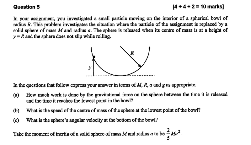

nehcrow Messages 15 Reaction score 0 Thread starter Jun 1, 2011 #1 Homework Statement Check attached image. Homework Equations The rotational motion formulas Ug = mgh The Attempt at a Solution Have no idea unfortunately :( Attachments help.png 31.9 KB · Views: 447

gneill Mentor Messages 20,989 Reaction score 2,934 Jun 1, 2011 #2 List the types of energy that will be involved and their basic formulas. Are there any relationships between these energies? (hint: consider that the sphere is rolling without slipping).

nehcrow Messages 15 Reaction score 0 Jun 1, 2011 #3 OK, so kinetic energy and gravitational potential energy. I got the first part correct, Ug = Mg(y - a) but the 2nd part... not so much :\

gneill Mentor Messages 20,989 Reaction score 2,934 Jun 1, 2011 #4 You've missed out an important form of energy. Why do you suppose the problem gives you the expression for the moment of inertia of a solid sphere?

nehcrow Messages 15 Reaction score 0 Jun 1, 2011 #5 Rotational kinetic energy? Sorry, I'm really lost when it comes to rotational mechanics, I need people to spell it out for me :(
