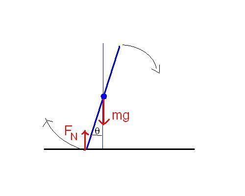

As soon as the rod is rotated off from its vertical position the normal force from the ground causes torque with respect to the CM. The rod will rotate around the CM while the CM falls. You have two equations, one for the vertical acceleration of the CM and one for the angular acceleration β about the CM. displacement of the lover end of the rod and the height of the CM are related through the rotation angle θ.
ehild,
That's excellent hint but I found the method given by Doc Al and arildno simpler. As it's not necessary that normal reaction has to equal force mg acting along centre of mass of the rod, CM of the rod may or may not fall vertically i.e. may or may not have linear acceleration vertically. But anyway, the two forces acting on the rod "will" produce couple on it. By symmetry of rotation, the centre of mass will land on the distance L/2 from its original position "horizontally" right. But the net external force acting horizontally on CM is 0, and it was initially at rest, therefore it must not change its position horizontally. To compensate for this change, the lower point of the rod must shift L/2 horizontally due left so that CM again comes in its original position.
Thanks everyone (arildno, Doc Al and ehid) !
Edit:
Sorry. Normal reaction does not pass through CM, and so there will be net force on the CM downward. Will it be mg or mg-R ? I think former is correct. Also if a rod is pivoted at the end and it is left swing in a semicircle, will there be linear acceleration in its centre of mass ?
