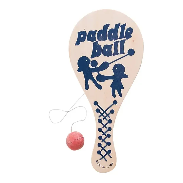

Same principle, maybe, with the paddle ball, though not too dangerous. Get it going really fast, and it gets a little tilted, misses the paddle on the backswing, and bonks you in the head or body. Remember that happening; fun, though.

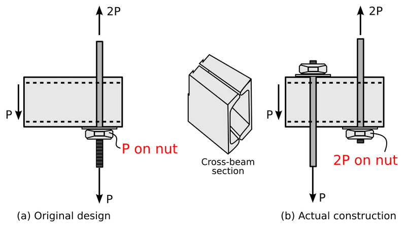

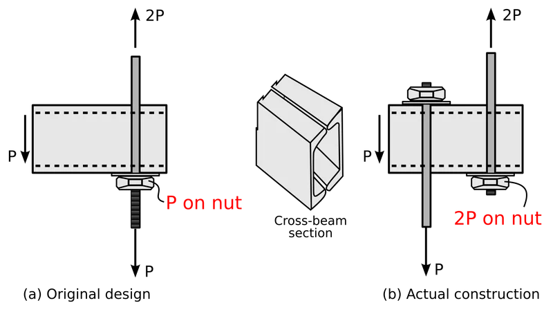

I'll vote for the Hyatt Regency walkway collapse in KC, 1981. It killed 114 people and injured 216.
Maybe not the worst disaster, but the simplest to understand once you read about the cause. A deadly misunderstanding of basic physics and unauthorized modifications of the engineering design.
Dunning-Kruger on display, one drawing says it all:

Huh. I guess the vertical supports weren't long enough and they had to do something. I confess it took me a while to figure out what the problem was, so I would have made the same mistake.

They were threaded rods and the contractor didn't want to take the time to thread the nuts up 15 feet of rod. That's why they asked for the change.

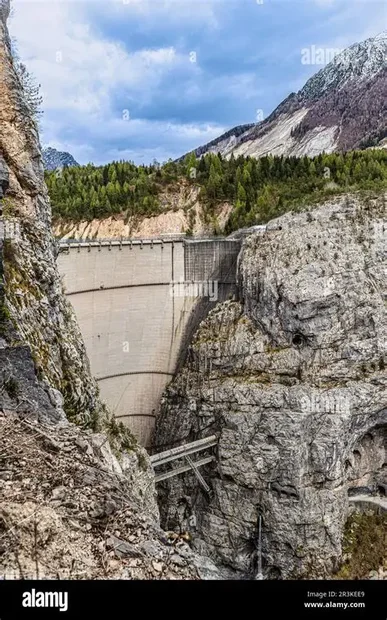

Not as big as this one was supposed to have been, though, with no video of this event at failure. Wave generated from a landslide into the dam, the displacement water wave over the top of the dam with a height of 200m, almost as tall as the dam face, in Italy. Oct.9,1963, nearly 2000 killed, 487 children.

Those rods don't seem trivial to make. I would guess you need a fat section in the middle for the thread, or maybe a special clamping sort of nut. I wonder what the original detailed design was. Welded sections?

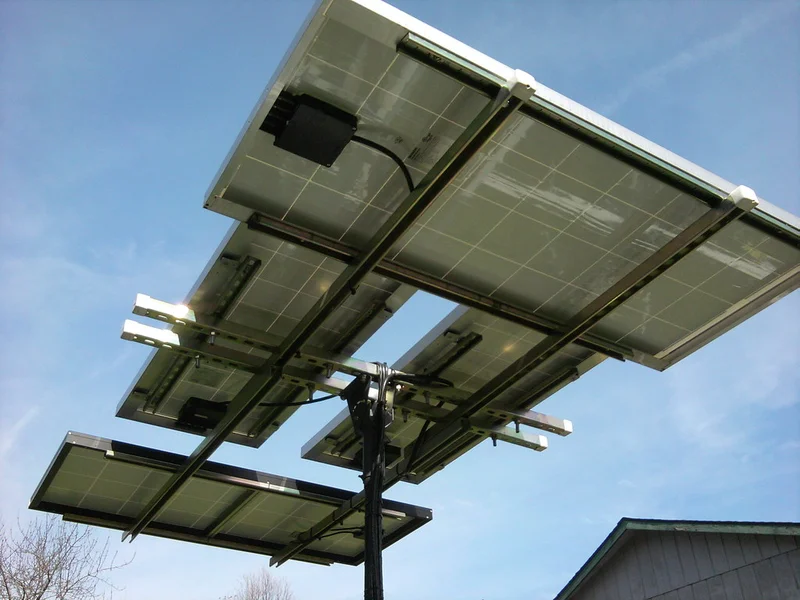

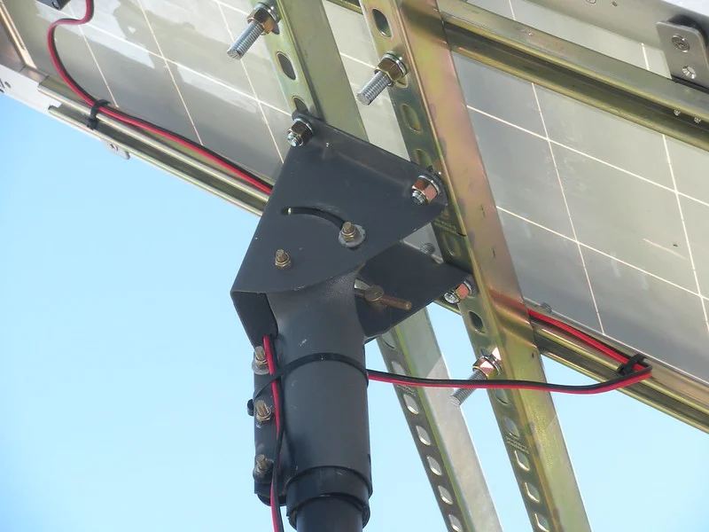

They are an extremely common construction component, they just aren't usually that long. So common that for smaller assemblies you don't even need a structural engineer, there's books of standards for things like ductwork, piping and small equipment construction/support. This commonality probably contributed to complacency about the construction.
Note; they are all thread. So they are often called allthread (might be a trade name):

With allthread and unistrut you can build just about anything but you do need to tighten the nuts.
