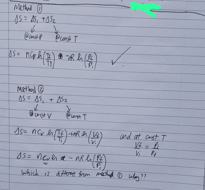

Calculate the change in entropy for the system when ##2## moles of a diatomic perfect gas, for which the molar heat capacity at constant pressure is ##\frac{7}{2} R##, is changed from 25 degrees Celsius and 1.50 atm to 135 degrees Celsius and 7.00 atm.
##\Delta S=\int_i^f \frac{dQ_\text{rev}}{T}##
Method 1 is the standard and (probably) the correct answer. I was fiddling around with it and don't understand why I get a different answer using method 2. If the gas is changing pressure, then it is changing volume. So why can't I sum up the entropy changes using method 2?
Using method 2 with V, by ##PV=nRT## I get ##V_i=32.61 \text{ L}## and ##V_f=9.33 \text{ L}##. So plugging in I end up with ##\Delta S = -7.7 \text{ J/K}##, whereas in method 1 I end up with ##-7.3 \text{ J/K}##. With method 2 with P I get ##-12.6 \text{ J/K}##.
Plot the paths on a P-V graph to see clearly what is happening.
Method 1: a. Heat from Ti to Tf at constant pressure Pi;
b. Compress from Pi to Pf at constant temp Tf.
Method 2: a. Heat from Ti to Tf at constant volume Vi;
b. Compress from Vi to Vf at constant temp Tf.
What is the pressure at the start of step 2b? It is not Pi.
Your mistake is in saying "at constant T, Vf/Vi = Pi/Pf".
For the whole process, T is not constant, so Vf/Vi ≠ Pi/Pf
By the way, for method 2 using V, I get the same as for method 1 using P (-7.3 J/K). Check your calculations.

Thank you. Drawing it out was a good idea. Yes, in method 2 I used temp of 125 degrees rather than 135 degrees! It all works out now, cheers.
